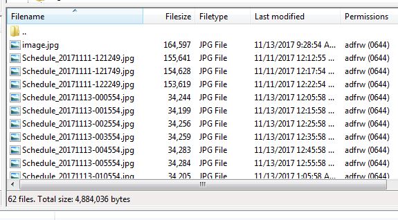

Here is a snip from FileZilla. They all start 'Schedule' followed by the date and time numbers added.
I'm thrilled I finally have these cameras off of Wunderground. I would have done it a long time ago if I had realized there was a way to deal with the screwy file naming on these Foscam cameras. A support tech emailed someone on Wxform they were announcing the end of the webcams this week and all cameras will be dropped from WU on December 15. I know you are not surprised at all and neither am I at this point.

Re: Webcam Block - WU dropping them
the you could try:
if ($images = glob("Schedule_*.jpg") ) {
foreach($images as $img){
unlink($img);
placing this at the end of the script
unlink($img);

Thanks. That works fine. I also figured out I don't need to 'unlink' the image.jpg if I apply the same 'if' condition you listed. If I'm starting to understand this code better -- I probably don't need that second 'if' condition since it's the same as the first one. Here is what I'm using. The only files left in the directory are the current image.jpg and this script file I'm triggering from the Meteobridge, exactly what I wanted. Now I can start configuring the webcam plugin referencing the current image from both cameras.
<?php
rsort($images);
$img = $images[0];
$newfile = 'image.jpg';
copy($img, $newfile);
unlink($img);
