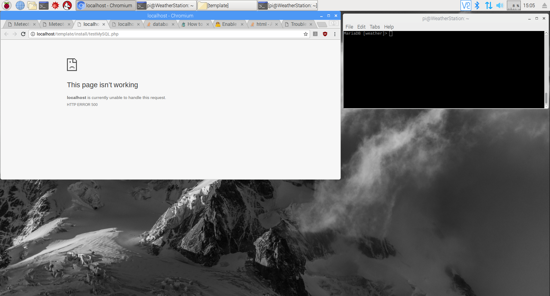

I have the raspberry pi with the latest update and upgrade.
I have installed and configured successfully apache2, mariadb (mysql), php.
I launch successfuly setup.php
The 3 server tests are successful.
I have created a weather database with user pi
I can connect to mysql successfuly with user pi
When I test the mysql connection I get this error:
This page isn’t working
localhost is currently unable to handle this request.
HTTP ERROR 500
anybody have ideas of what I am missing?

Try adding this at the end of the url:
?errors
If it does not help then the only possible way of diagnosing the problem is looking in the error log
?errors

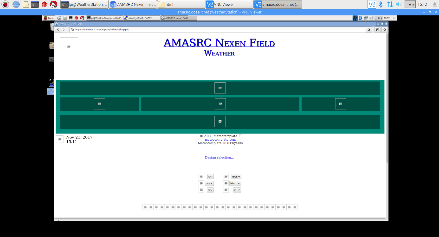

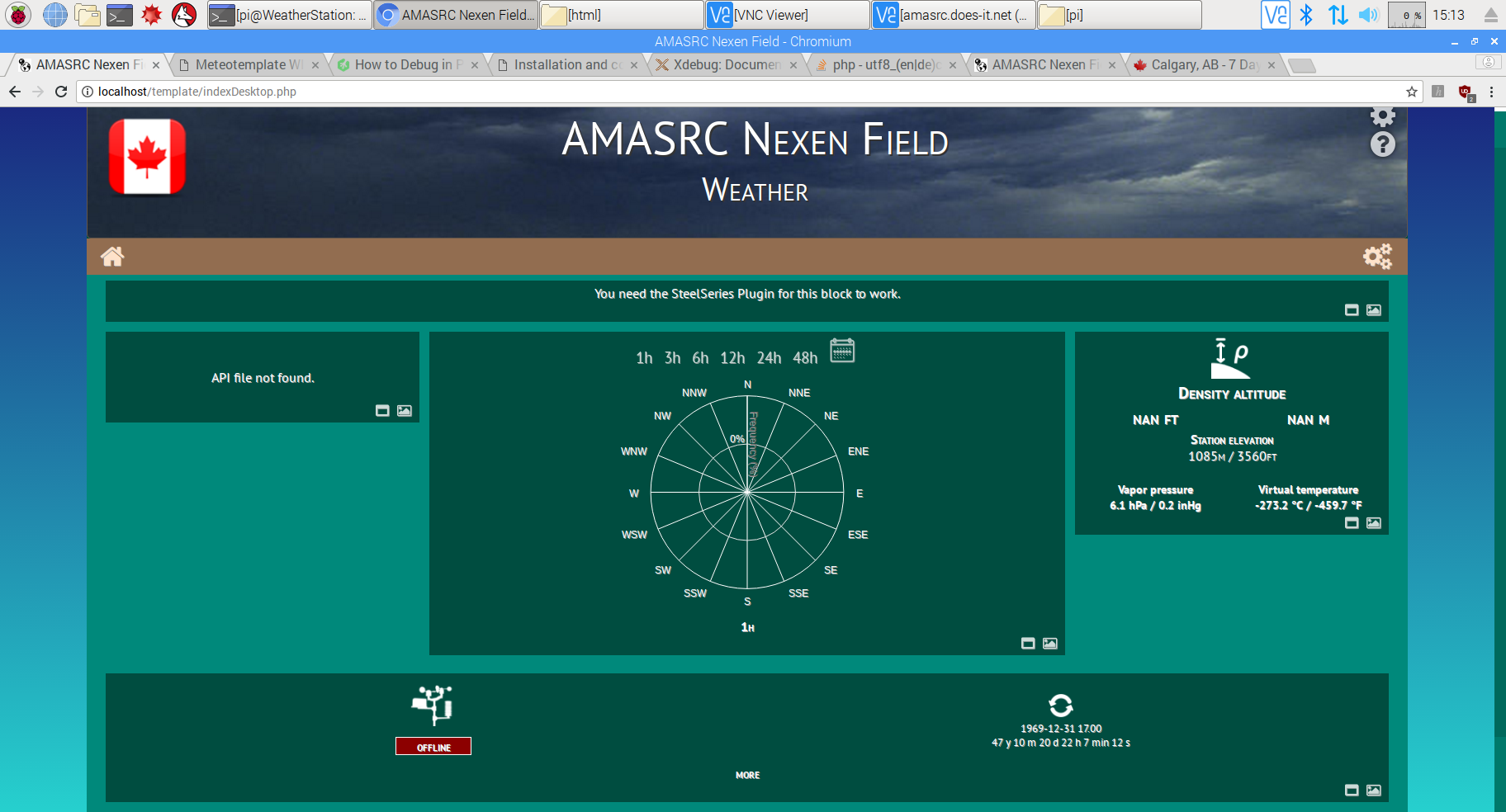

I have downloaded some blocks and have done a test layout setup.
There is only one data record for now.
I have attached two screenCaptures; one generated on the local computer where mysql an meteotemplate is defined.
the other from a remote computer trying to load the meteotemplate web page.
The remote site does not see any icons or blocks properly.
What am I missing?
What am I missing?

Re: Installation and configuration on Raspberry Pi 3
I cannot help you unless you give me a link. Screenshots are usually only informative - I can say "yes, it doesnt work"
try:
pierre.does-it.net
no www. before the link above.
pierre
pierre.does-it.net
pierre

Pierre,
I was able to pull up your page. It's pretty slow.. I think I know what's going on..
Under the main setup file, do you have the paths setup correctly?
Leave the Path as default: /
The Page URL should be: http://pierre.does-it.net/template/
Scroll to the bottom and save it. The links that does load is pointing to localhost, which I will not have access to. After the change, you will access your page from the link above, and not via localhost.
EDIT: Jachym just beat me to it.

Got it.
Thank you very much...
I corrected the entries is the setup.php and all works fine now.
BTW I am not copying the template from one computer to another, I am simply running it from a remote computer.
It is slow because it is running on a raspberry pi 3.
