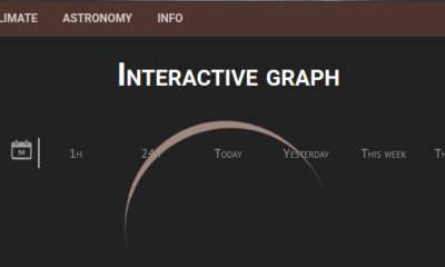

Interactive graph page loads, but sits with the spinning indicator.
I scrolled up, and noticed this at the bottom of the page of the Interactive graph.

The strange elements are still at the bottom of the Interactive Graph page. (Okay box, and the words to: and from:)
