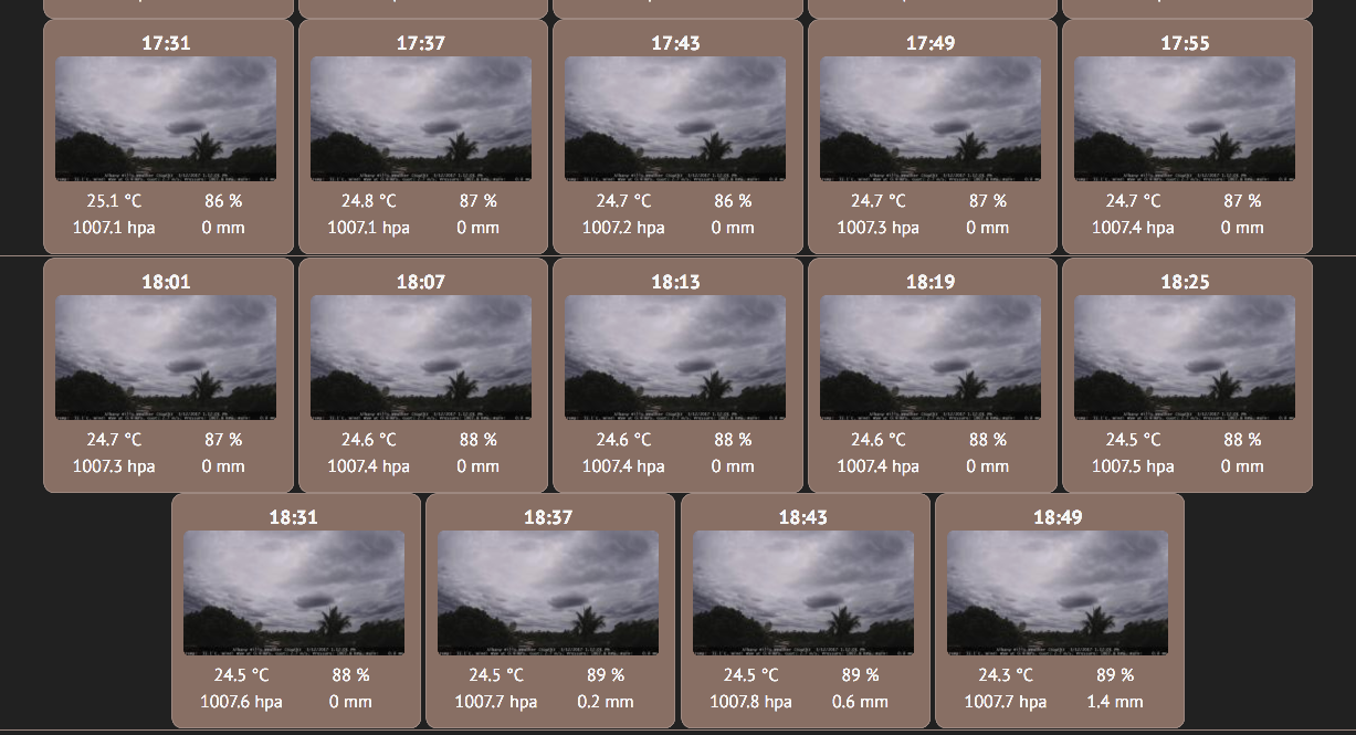

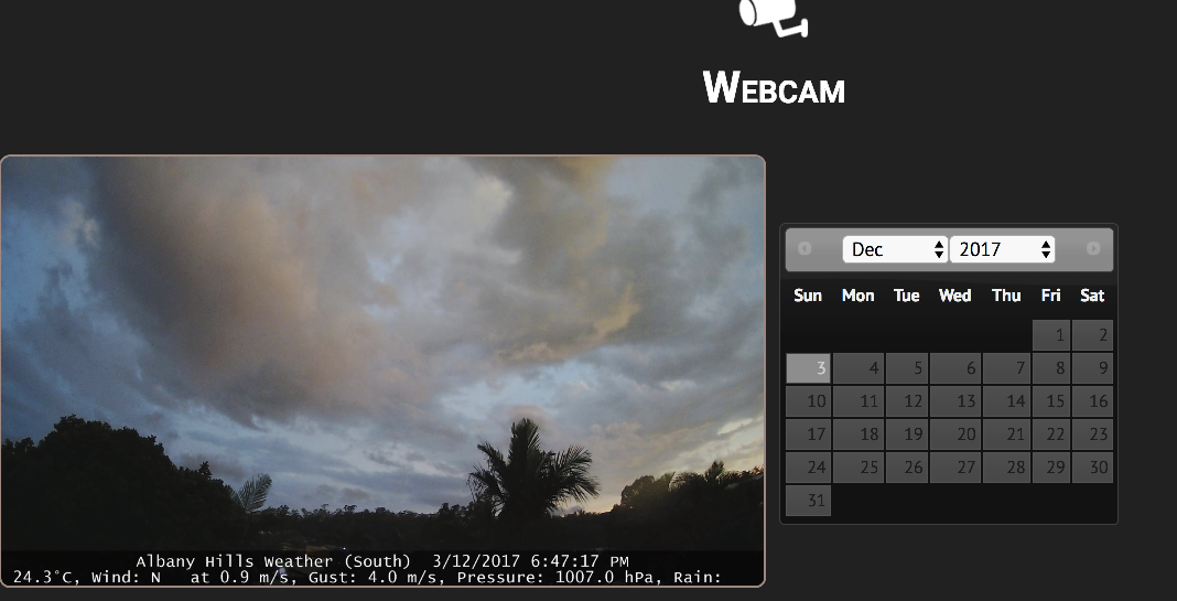

So I am having an issue with the webcam plugin not saving the current image at each interval. It seems to be keeping a copy of an older image even thought the current image shown at the top is current.
Appreciate any assistance provided.
Screenshots attached to give example of that I am seeing.
Screenshot at 18-51-25.png (136.16 KiB) Viewed 2653 times

Okay so I have determined that the plugin update php is using a cached image. Not quite sure how it is happening since its a hosted server but I found a way around it by modifying the CRON updatewebcam.php file as follows:
			$imageFile = file_get_contents($imageURL);
to
			$imageFile = file_get_contents($imageURL.'?'.mt_rand());
This forces the URL to be different everytime and therefore obtains a clean (uncached) copy of the image.
