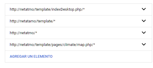

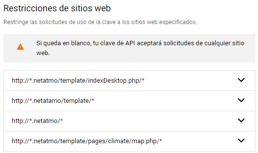

I also have this same error.
My authorized sites are the ones in the image.
What am I doing wrong, should I change the syntax of the authorized page?
It is necessary to clarify that my "template" is hosted on a Raspberry Pi 4 and is only accessible by computers placed on my local area network (LAN). It is not accessible via the Internet (WAN).
Thank you very much for your help.

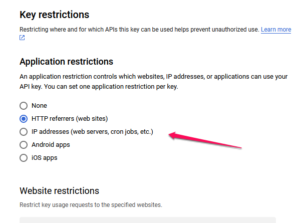

Re: Climate map won’t show up
Not sure you specified correctly the restriction.
You may try specifying the ip address of your raspberry ( 3rd option )
Thank you very much for your interest.
If I enable "IP address ..." I get an error "Invalid cidr addressblock", when I type http://192.168.150/ or http://*.192.168.1.150/*.
I think the correct option is "HTTP referrers", but my mistake is in the syntax.
I'm typing http://*.netatmo/template/pages/climate/map.php/*
How should I use the (*) and the (.)?

Solved.
I activate "HTTP referres" and change the syntax as you can see in the image.
The example suggested by Google is confusing.
My compliments to Jachyn's excellent work.
Best regards.
Best regards.
