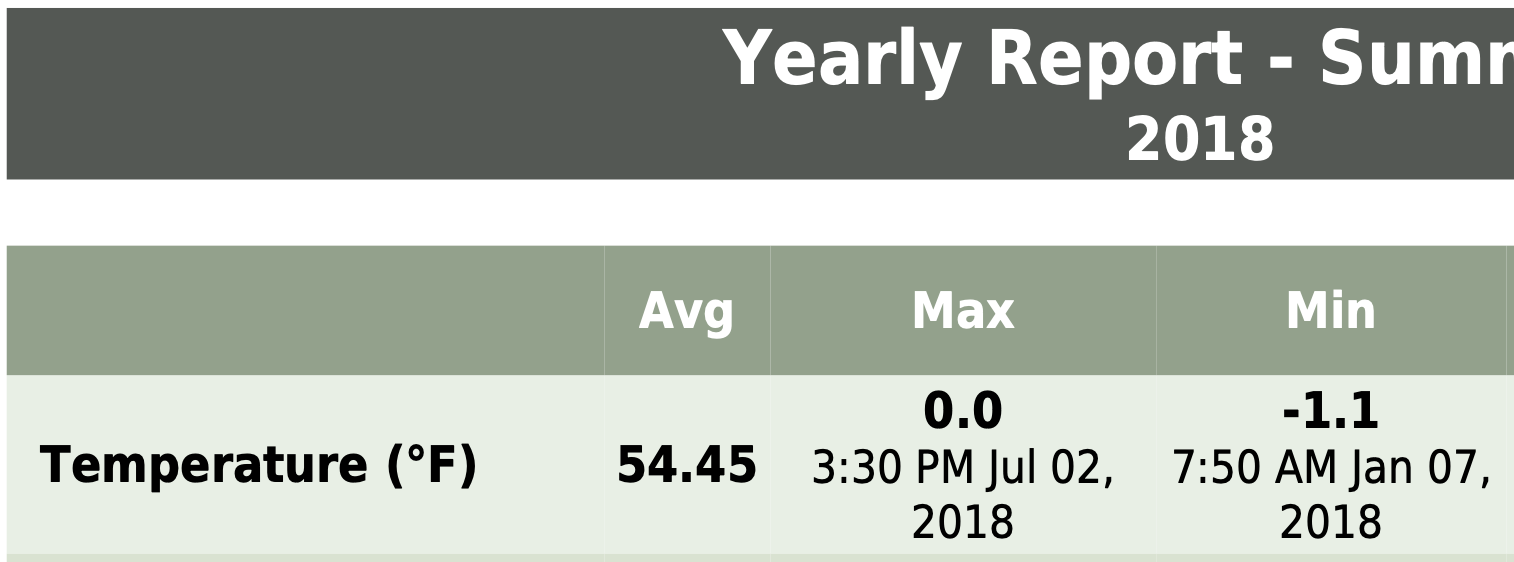

If you look at the Yearly Reports there is an option to generate a PDF version. While this is likely a feature that does not get used often, if you do run it you will notice that the Maximum Temperature shows 0.
Before Fix
Before Fix
Screen Shot 2020-01-02 at 7.27.06 AM.png (77.47 KiB) Viewed 5642 times

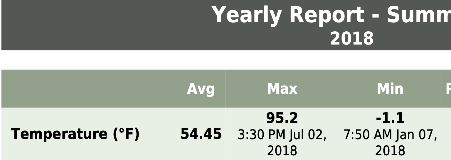

After fix
After fix
Screen Shot 2020-01-02 at 7.34.18 AM.png (78.67 KiB) Viewed 5642 times

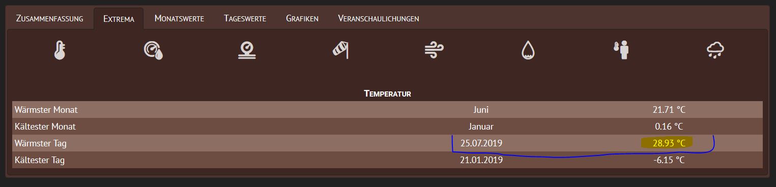

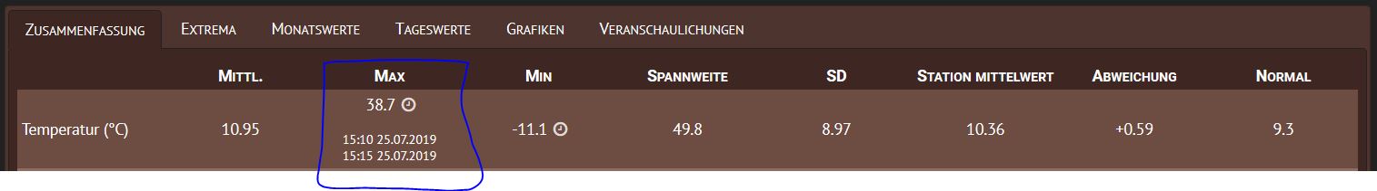

I have another problem in yearly report.
In Tab Summary the warmest day in year was 25.07.2019 with temperatur max. 38,7 °C.
In Tab Extrema the warmest day in year was 25.07.2019 with temperatur 28,93 °C.
The same problem with coldest day.....
s. Attachment
Michael

Hello
These are the coldest and warmest days at average temperatures in Extremes
