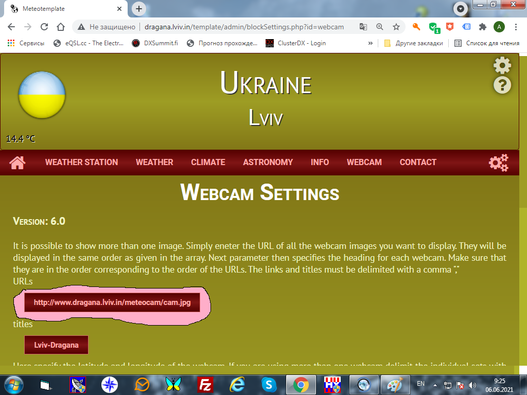

Good afternoon David! Again you are helping me, thank you. With the camera block it does not work with the plugin too. First, tell me why the block does not work. Soft BlueIris5. See screenshots.

Try to place your webcam image in the template directory
http://www.dragana.lviv.in/template/meteocam/cam.jpg
your link is dead
http://www.dragana.lviv.in/meteocam/cam.jpg

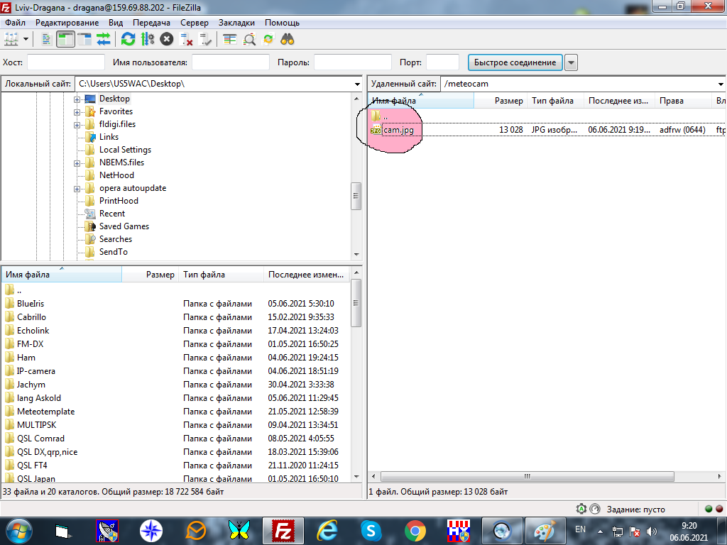

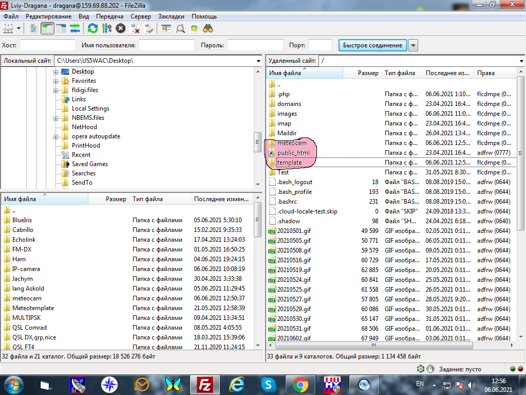

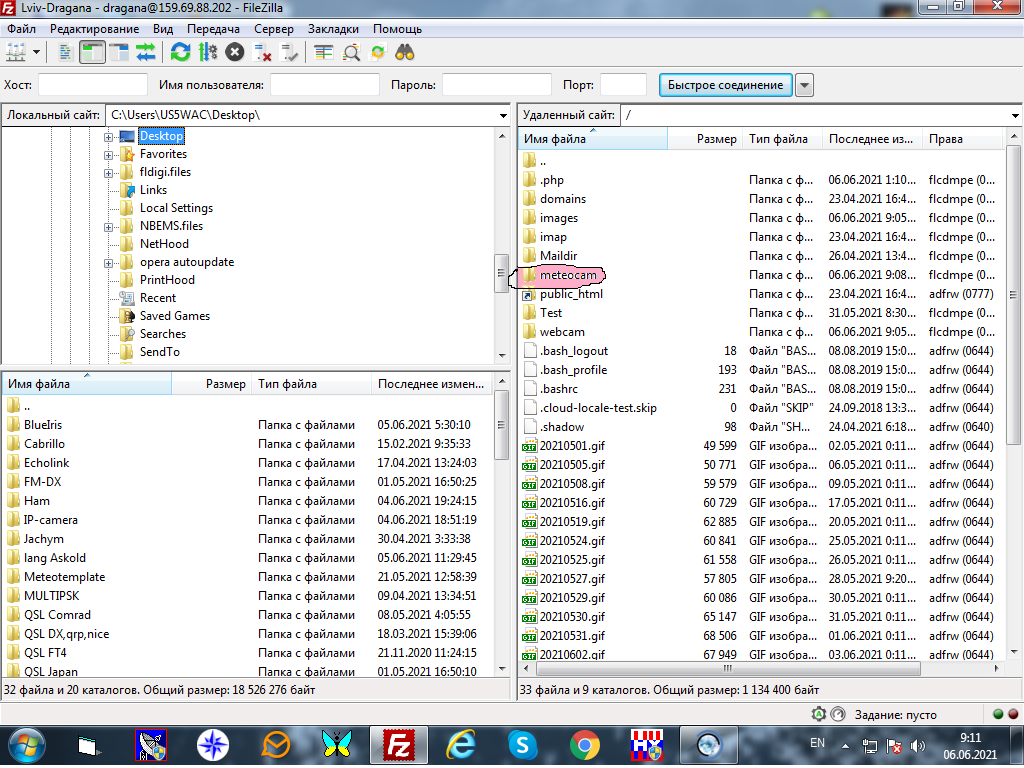

Thanks for the answer. I create the path / template / meteocam / and the meteocam folder, but the .jpg file does not go into it inside public_html, but two folders are formed before public_html and the .jpg file is placed in them.

I found the correct path through the / domains / directory for the .jpg file The block and plugin webcams are working !!!
/domains/dragana.lviv.in/public_html/template/plugins/webcam/images/
