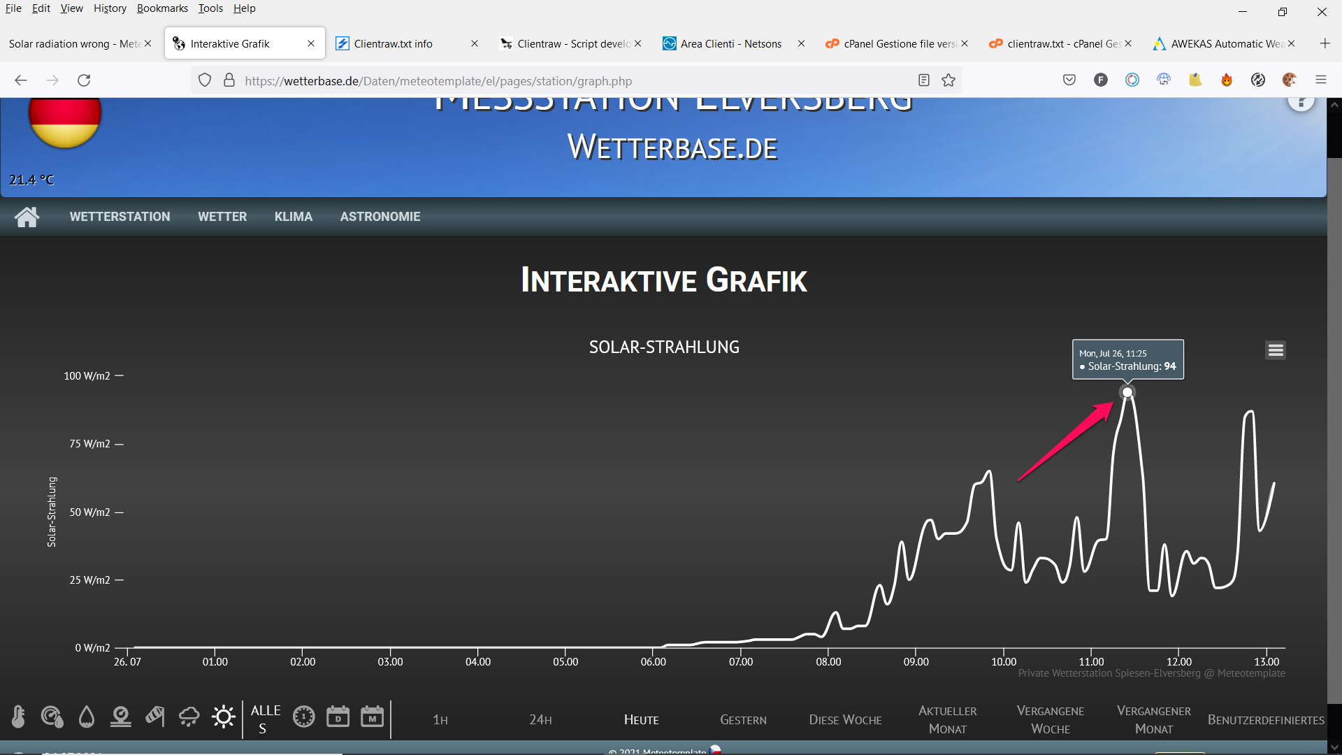

Hello everyone!
I have a problem with the display of solar radiation.
The instrument always shows too little. I included a picture.
12 w/m2 are displayed, but in reality it is 120 w/m2.
How can I change this?

Here is the link to the Meteotemplate of the Elversberg station:https://wetterbase.de/Daten/meteotempla ... esktop.php
Image Awekas: Image
Image Meteotemplate: Image

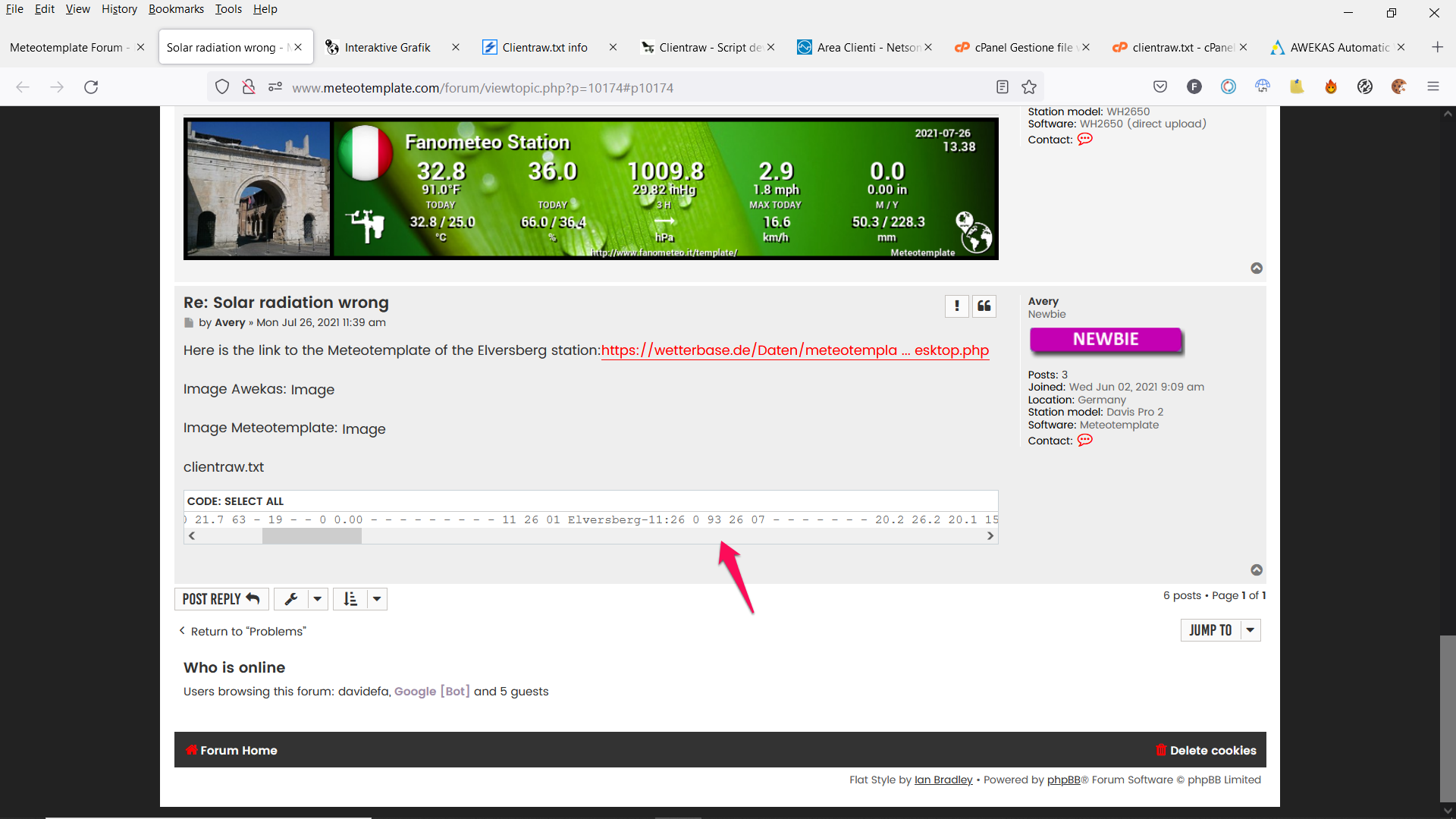

clientraw.txt
12345 0.0 0.0 36 20.2 87 1009.2 0.00 0.00 0.00 0.00 0.00 21.7 63 - 19 - - 0 0.00 - - - - - - - - - 11 26 01 Elversberg-11:26 0 93 26 07 - - - - - - - 20.2 26.2 20.1 15.1 19 Zunehmend_bewölkt_mit_geringer_Temperaturänderung. 0 0.0 0.0 0.0 0.0 0.0 0.0 0.0 0.0 0.0 0.0 0.0 0.0 0.0 0.0 0.4 0.0 0.0 0.4 0.0 0.7 3.5 18.0 880 26/07/2021 26.4 18.8 20.1 15.1 4.2 0.0 0.0 0.0 0.0 0.0 0.0 0.0 0.0 0.0 0.0 18.6 17.6 15.7 15.1 15.2 15.5 15.8 16.0 16.3 16.6 0.00 0.00 0.00 0.00 0.00 0.00 0.00 0.00 0.00 0.00 20.1 15.1 20.2 0.0 0 _ _ 292.5 _ 0 - - - - - - - 856.0 22.1 21.4 - 1009.5 1007.2 0.8 10:34 09:49 - - 18.4 14.4 0.0 2021 _ 1 0 1 338 45 0 0 0 0 293 293 293 315 - - 0.0 - 49.316389 -7.12 - 97.0 88.0 - 06:38 !!C10.37Of!!

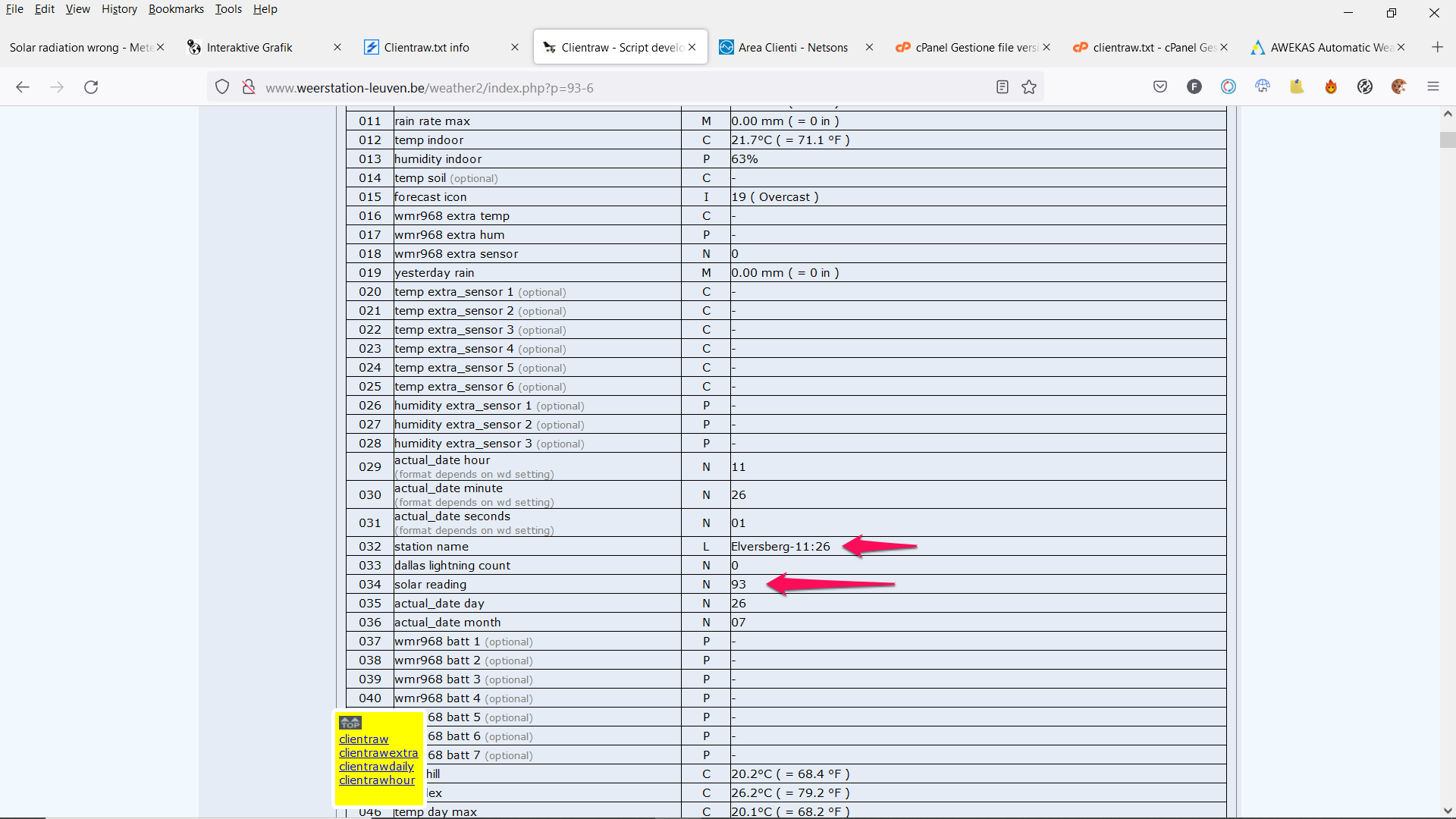

Re: Solar radiation wrong
Post by davidefa » Mon Jul 26, 2021 11:42 am
Your clientraw.txt in field 34 ( solar radiation field ) contains 93 and this is reported by meteotemplate.
So your clientraw.txt contains an incorrect solar radiation value.

Post by Avery » Mon Jul 26, 2021 4:28 pm
Okay, so parameter 34 is displayed correctly.
I think I found the problem.
Actually, the instrument should display the value of parameter 127. How can I change that from 34 to 127?
