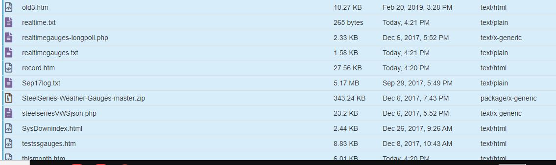

Post by BobW55 » Tue Sep 21, 2021 9:35 pm
Davis Vantage Pro2 wired
Solar/UV sensors
Sky Cam
Ham radio K8pos
Re: Server migrated to new SS gauges no longer work
Post by davidefa » Tue Sep 21, 2021 10:33 pm
Try calling 'manually' http://www.melvinweather.com/template/u ... ?password=*****
to see if it returns any error
