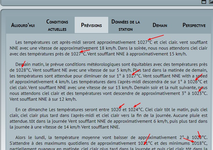

I have a problem with the temperature display (see image)
and thank you again for your work
- summary.jpg (149.91 KiB) Viewed 34203 times
Re: Problem on "summary" block
I agree... 1027°C is too much even for global warming ; - )
Hello Davide
update done, correct temperature, no worries
thanks again
thanks again

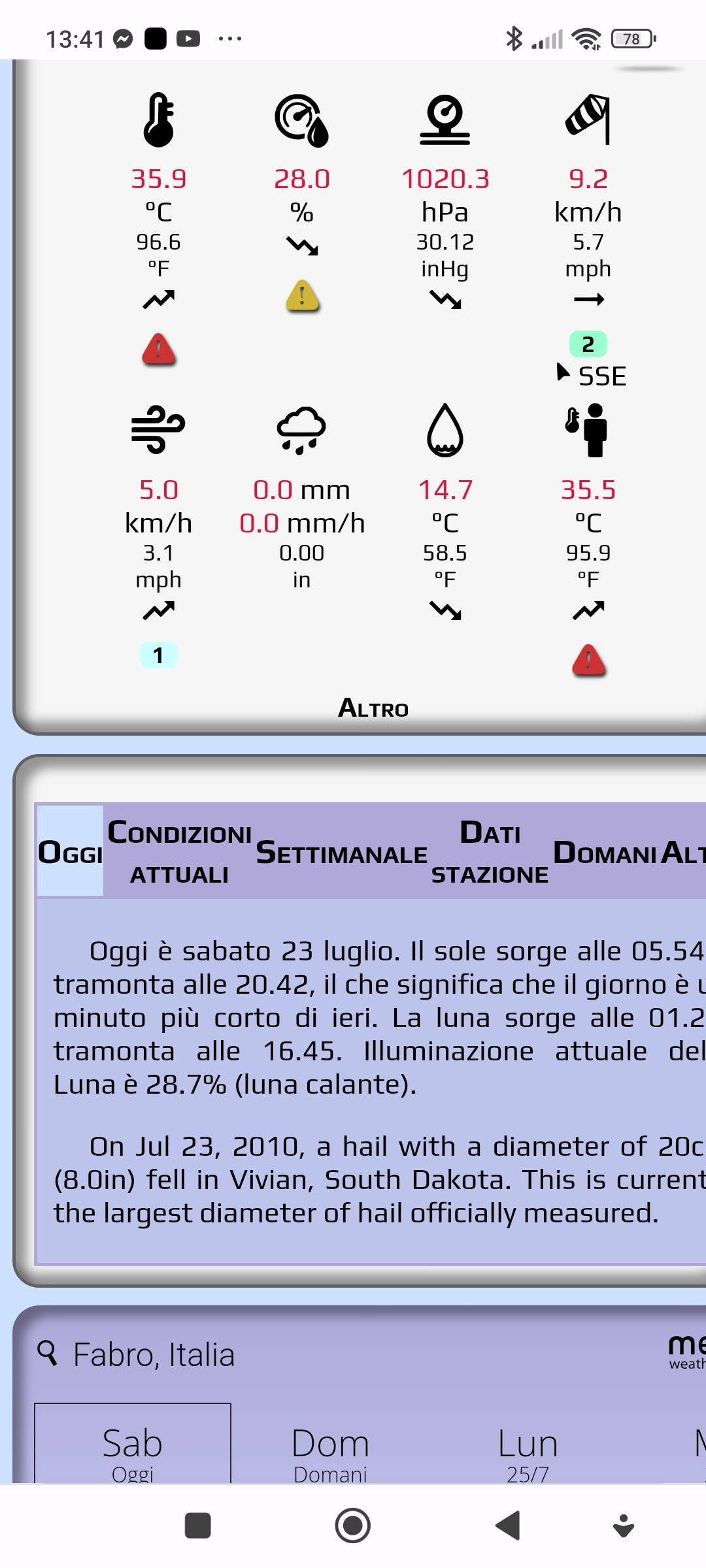

Hello Davidefa.
By adding the "Summary" block to the smartphone / mobile version of the meteotemplate, you have a strange formatting, causing the block to move the graphics of all the blocks beyond the right edge of the smartphone display, so they do not remain centered.
Is it possible to solve this problem?
This occurs only by adding the "Summary" block to the meteotemplate for mobile devices.
Thank you.
Thank you.

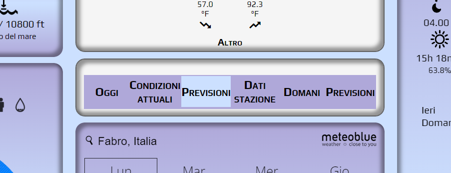

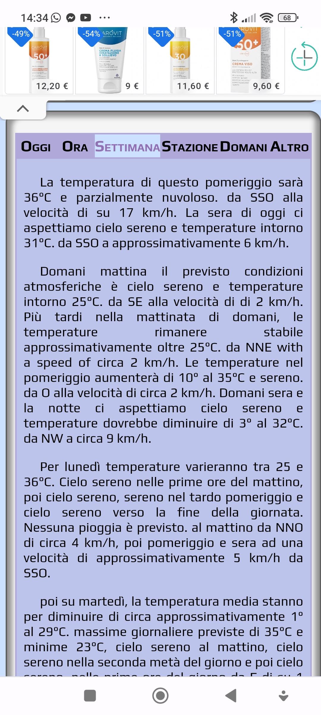

I have changed the menus of the block, they seem more appropriate to me. But I still haven't fixed the formatting of the menu items.
Example are the entries "Week", "Station" and "Tomorrow" are without separator space.
How can I solve the problem?
Sorry forgot to check your question:
solution a) rotate your phone ( sorry, this is my preferred solution as I have to do nothing ; - )
solution b) we can arrange the 'selection tabs' as a 'drop down menu' ( as the key factor is the length of these tabs )
solution c) we have to define 'super short' tabs headings ( shorter than you did ex: "Oggi Ora, Set. Staz. Dom. Altro" ), not very clear in my opinion, but easy to do
