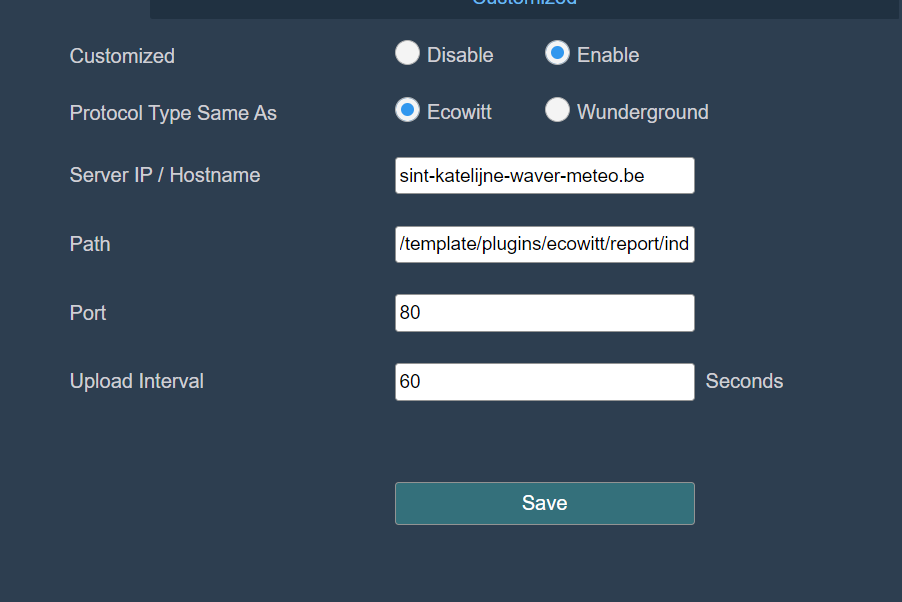

The gw1X00 custom upload can't upload to an https server ( as in your case )
Possible solutions:
- disable the 'https rewrite rule' for the directory template/plugins/ecowitt/report ( or for the whole site )
- on this post on wxforum is explained how to do it on servers ( apache ) using file .htaccess and on IIS server ( microsoft )
- on this post user meteoesine explains how he did
Possible solutions:

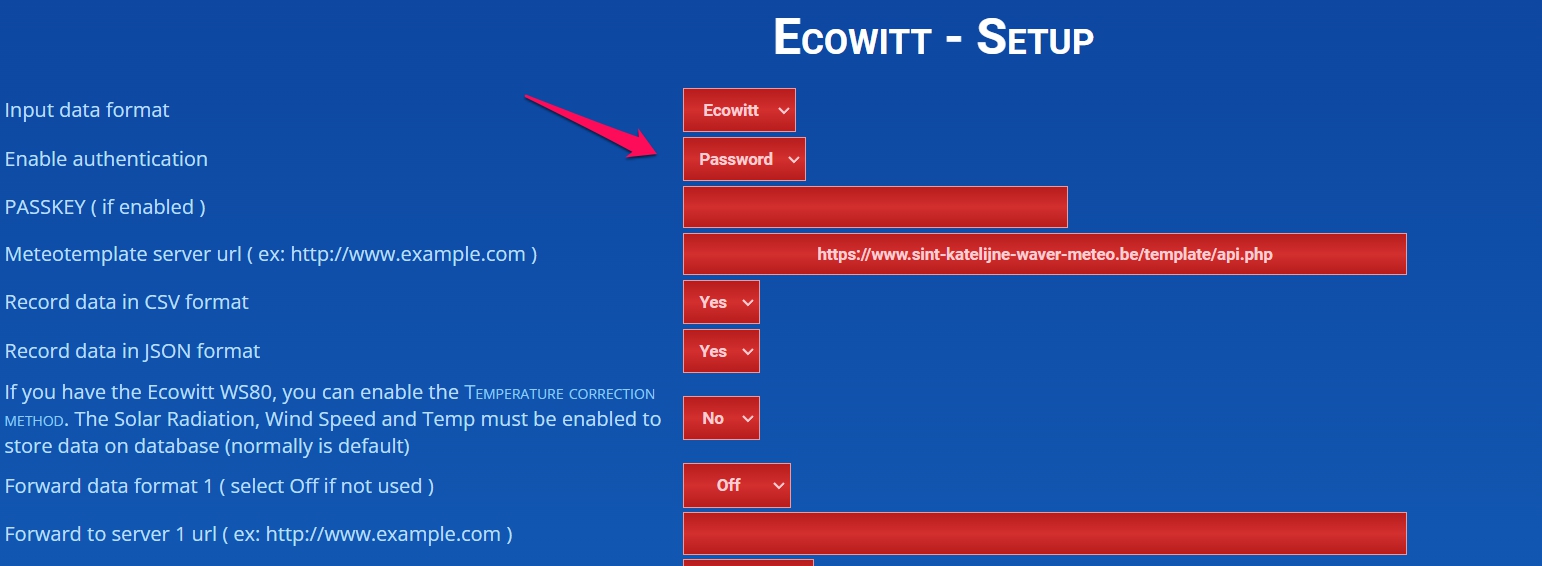

thx, did the .htaccess
got data coming in every minute in csv and json format.
but api is not updated
see screenshots did I miss something?

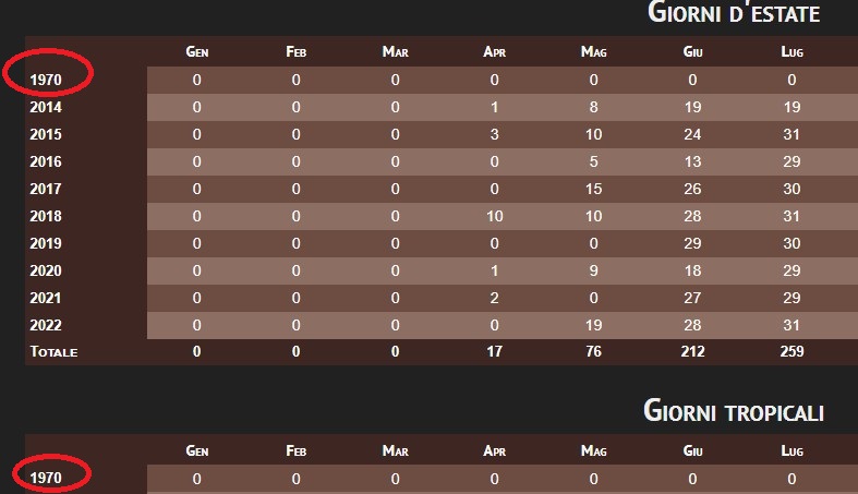

why in the all reports I find the year 1970 without data?
I checked in phpmyadmin and i don't see any record before 01.01.2014
is there a possibility to remove it?
tnx
tnx
- ScreenShot01122.jpg (69.92 KiB) Viewed 13840 times
Re: a lot of issues
Try executing the following query in phpmyadmin:
and post the result
SELECT max(Tmax), min(Tmin), max(R), max(G), avg(W), min(P), max(P), min(H), max(H), min(D), max(D), min(A), max(A), max(S), max(RR), YEAR(DateTime), MONTH(DateTime)
FROM alldata
GROUP BY YEAR(DateTime), MONTH(DateTime)
ORDER BY DateTime- meteoesine
- Posts: 186
- Station model: Davis Pro2+
- Software: Meteobridge nano
Re: a lot of issues
found the damn
removed
thnx a lot
