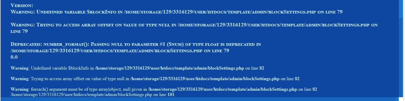

Post by hcorrin » Sat Aug 20, 2022 9:49 pm
this what showed up
i tried this https://www.hc-iom.co.uk/template/admin ... hp?&errors
and got
part 3 in new post

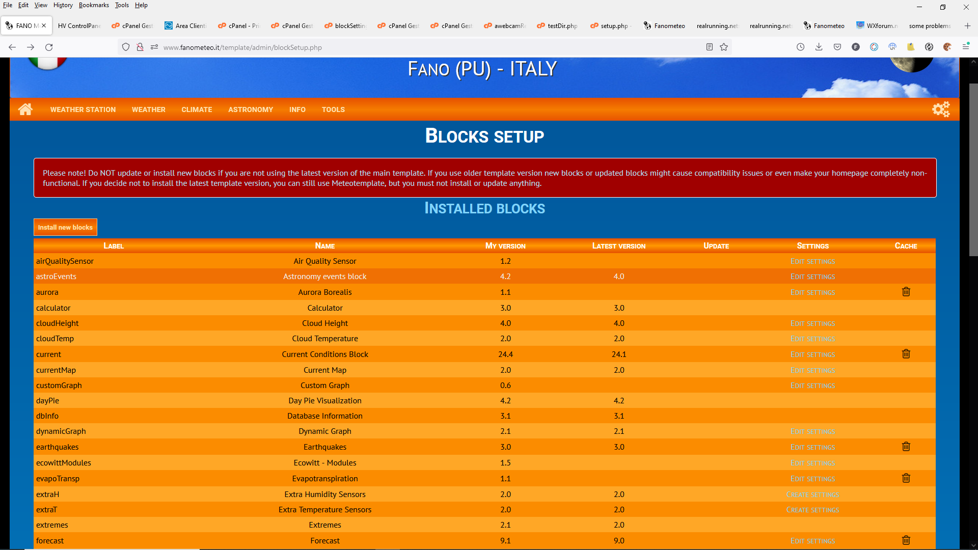

Re: some problems with php8.1
Post by davidefa » Sat Aug 20, 2022 10:30 pm
Sorry, I think I didn't understand your initial statement ( if I'm not wrong, the first image shows that the forecast block setup returns only minor warnings but no fatal error, and it should work as expected ).
So you are not able to access this page:
In any case reload the page that generates the error appending an '?errors' ( or '&errors' if the url already contains an '?' )

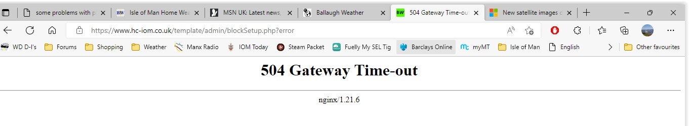

Post by hcorrin » Sun Aug 21, 2022 6:51 pm
sorry if i did not explain it very well
yes your block_setup1 image in last post is what i am having the problem with
i tried as suggested https://www.hc-iom.co.uk/template/admin ... .php?error after login in and got the attached
blocksetuperror (2).JPG (75.48 KiB) Viewed 41158 times
error log info from server

from this i assume i need to do the same with the indoor block plus any other blocks that stops the script before the finish
if every thing works to the end what should i see ie the main block setup screen or something else
Harold
Post by davidefa » Thu Aug 25, 2022 8:36 pm
Yes to both questions.
If your blocks do not contain any sensible/personal data, could you compress the whole homepage/blocks directory and post it ( or pm to me ) so that I can test it on my computer ( as this thing is quite weird, in my opinion ), include also the grLevelX block
P.P.S.
another question:
How log does the script takes to execute?
Does the gateway timeout appear?

unfortunately the zip file of my blocks is 10.3mb so unable to attach have uploaded to my website as 2 zip files
https://www.hc-iom.co.uk/wd_forum/Blocks1.zip this one has the blocks left after removal of others
https://www.hc-iom.co.uk/wd_forum/Blocks2.zip this one has the removed files in
the 504 comes 1 minute after clicking go even with the removed blocks
i would not be surprised if it works ok for you
thanks
Harold
Post by davidefa » Fri Aug 26, 2022 7:06 am
Yes, indeed it works on my test server
hcorrin
Posts: 40
Joined: Tue Sep 05, 2017 10:55 am
Location: Ballaugh
Station model: Davis VP2
Post by hcorrin » Fri Aug 26, 2022 7:39 pm
yes that's what I expected to happen
I changed to 8.0.22 but that did the same but at least the import data worked on that, unlike 8.1.9 which stopped after the first line.
i suspect that there may be another php command not allowed on the server, i know the eval is not
I'll have to decide whether to keep or retire the Meteotemplate on my hosted server
thanks for trying to sort
Harold
PS
runs ok on my synology unit so still can use Meteotemplate
