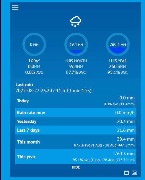

Hi to all,
is it possible to edit rain data on rain block?
If yes, how to?
Thanks in advance.
Alessandro

I would edit month (and year) rain because that data is wrong.
It shown much more rain than real because a bird (tortora) nested on main rain gauge all summer
I've tried to edit last line of db but without success.
Would i use phpmyadmin?
Alessandro
thanks for reply.
Alessandro
