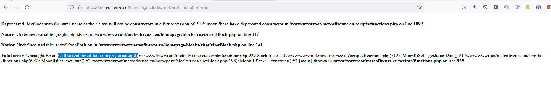

The error returned by the block is the following:

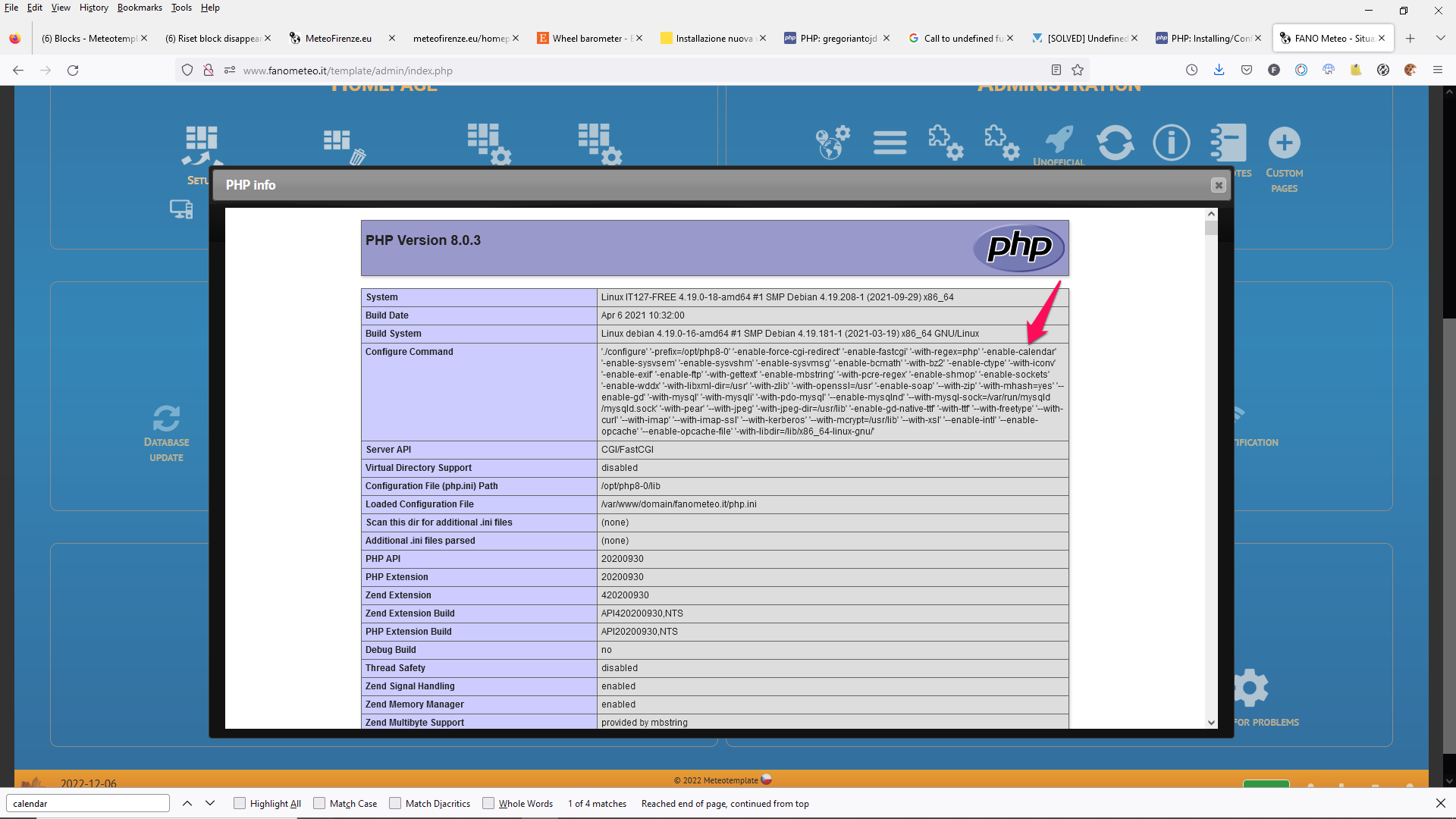

You need the 'calendar' extension installed in php ( see my phpinfo with calendar enabled ):
This extension is supported since php 4.
