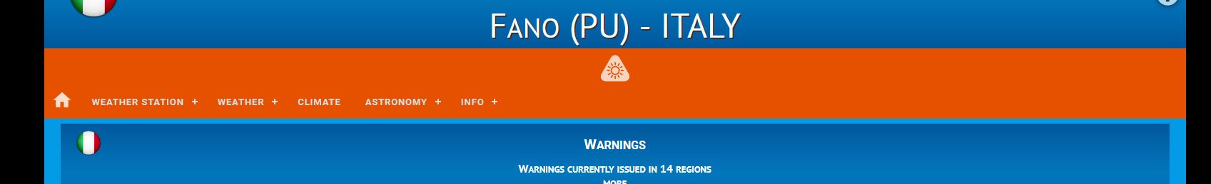

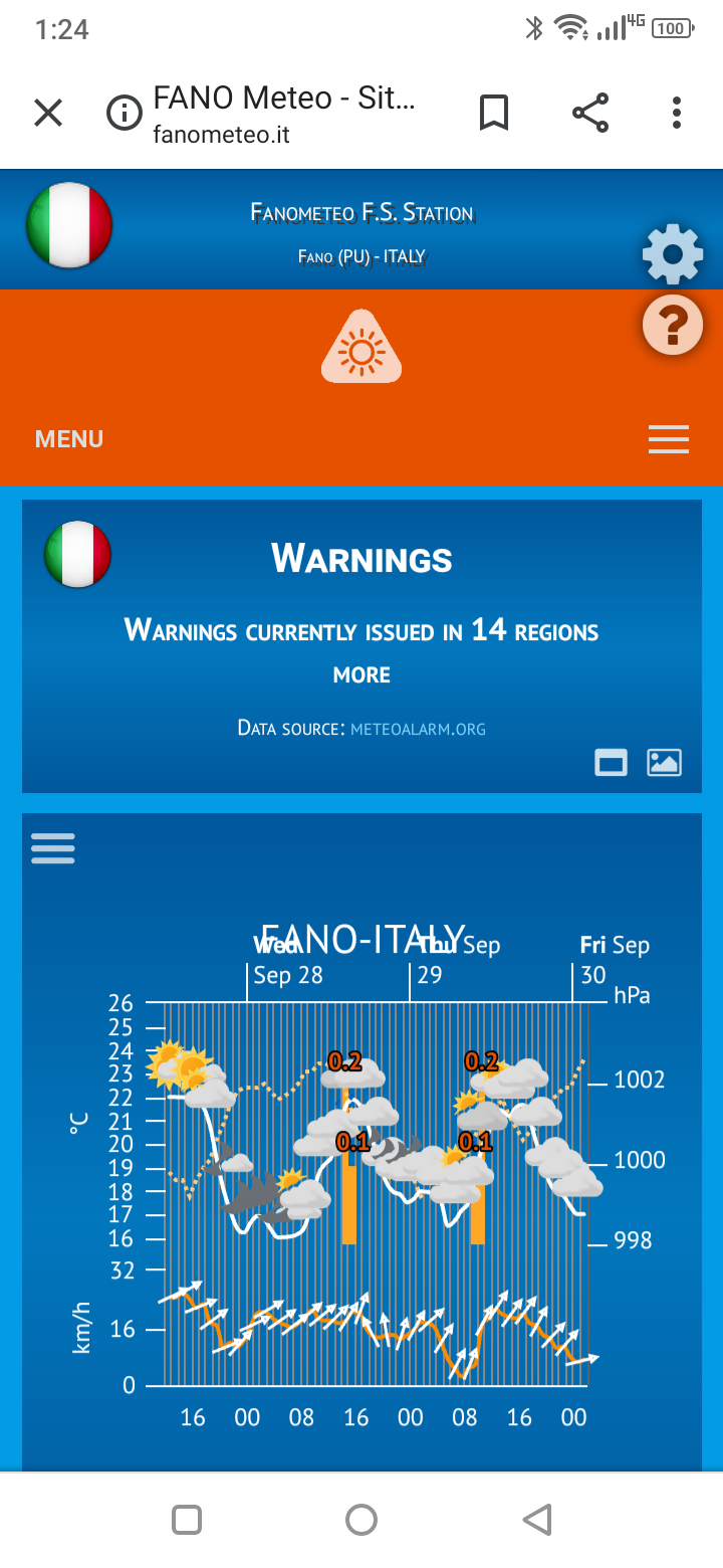

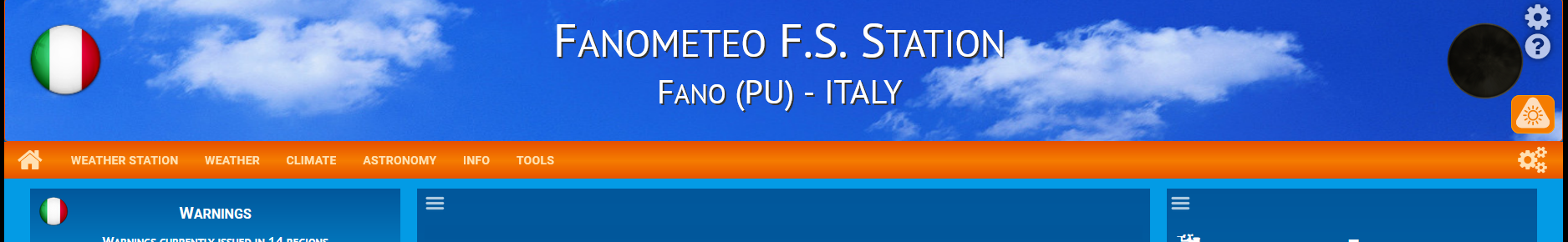

Not sure to understand correctly the question:
- are you referring to the menu 'look' ( in mobile/desktop version )
- or to the 'menu content' ( in mobile/desktop version )
I think the menu content is fixed in both versions, the look is a little bit different but I think both can be changed.
Desktop in desktop browser
mobile in desktop browser
mobile in mobile browser
