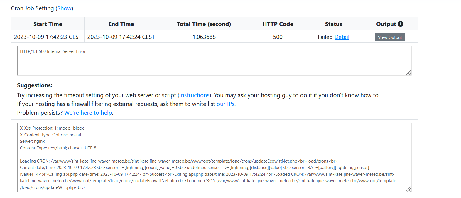

this is strange because at that moment there was no cron job updatWLL.php in place.
I put the updateWLL.php back in place, run it manually and I still get a 500 error. See picture.
thank you for your time!
Schermafbeelding 2023-10-09 174827.png (82.65 KiB) Viewed 27428 times
Posts: 225
Re: davisWLL
Post by alexvanuxem » Mon Oct 09, 2023 4:33 pm
HI David
i isololated the issue, the cron.php can't handle multiple cron requests
It's either updateWLL or updateEcowittNet.php
both gives a 500 error.
Re: davisWLL
Post by davidefa » Mon Oct 09, 2023 6:40 pm
Thanks for checking ( and reporting ).
Can't understand why this happen, but maybe it has something to do with the fact that both scripts are calling api.php.
Need to dig further.
