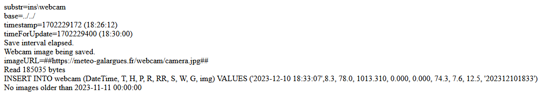

- please install the attached plugin, it is already configured with your data, so no need to run the setup ( for the moment ).
- check that the plugins/webcam and subdirectories have the 'right permissions' ( it depends on your server, it could be 0644, but could be different )
- execute the updateWebcam.php script directly in the plugins/webcam directory ( insert your password )
https://meteo-galargues.fr/plugins/webc ... E_PASSWORD
The result should be similar to this one:
you should now have an image in the images folder and you should be able to select day 10 from the calendar in index.php.
Wait 5 minutes and rerun the updateWebcam.php ( from the above link ), you should have the second image...
If everything is correct you can copy the updateWebcam.php script in the load/crons directory and ( hopefully ) your plugin should work as expected.

Post by Laglene » Mon Dec 11, 2023 3:24 pm
Good evening Davide,
I would like to thank you warmly for your prompt response and the help you provide to all of us.
For my part, I installed the version you posted.
Unfortunately, this doesn't work.
I am sending you the attached error code messages:
- Notice: Undefined variable: password in /public_html/www/plugins/webcam/updateWebcam.php on line 5
- Notice: Undefined variable: updatePassword in /public_html/www/plugins/webcam/updateWebcam.php on line 5
- Notice: Undefined variable: baseURL in /public_html/www/plugins/webcam/updateWebcam.php on line 9
Missing Webcam settings file, create one using the plugin setup.

Post by Laglene » Tue Dec 12, 2023 8:47 am
Hello to all the community,
Problem solved thanks to the intervention of Davide.
I thank him for his dedication, without him many problems would still have to be resolved.
He worked for me until midnight to find the solution and I am extremely grateful to him.
My webcam works.
Thank you Davide
