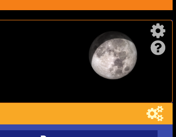

I always wanted to show the moon as it looks in the sky ( and it took me a 'fair amount of time' to accomplish this, svg rocks ).
Uncompress the archive in the meteotemplate base directory.
Note
The moon is shown tilted only when above the horizon ( is vertical when below the horizon ).
Tested working on firefox, chrome and edge.

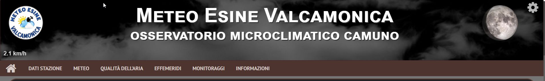

Re: Moon tilted
perfect
well done!
well done!
- Screenshot - 24_11_2023 , 16_44_31.jpg (67.43 KiB) Viewed 30240 times

Re: Moon tilted
I would like to say the same, but I don't see the moon.
Didn't see the moon, before update.
What am I doing wrong?
The header is set as interactive.
Thanks!
Alex
Thanks!
Alex
