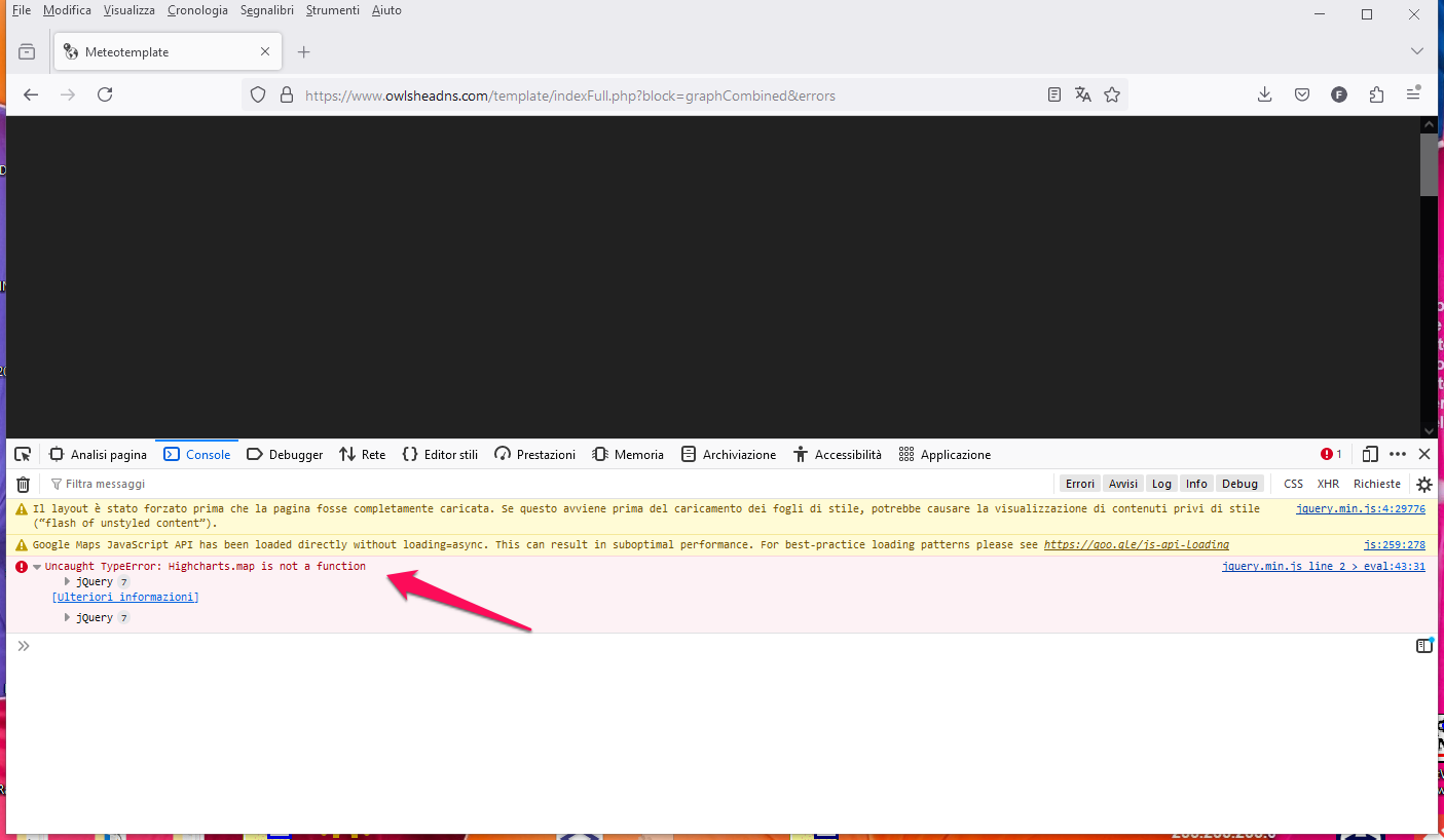

The block graphCombined suddenly stopped working today, Dec 2 2024 on my website: https://www.owlsheadns.com/template/indexDesktop.php
with no changes from me or from my ISP that I can see. The demos at: https://www.meteotemplate.com/web/blocks.php (and select graphCombined) are also not working.
I looked both using Firefox on Win 11 and Chrome on Android.

@lemini Thank you for the suggestion I try Davidefa's new version but it would not install for me. Perhaps I need instructions of exactly how to install Davidefa's version. I started this new thread because it seemed to me that my current problem was not like the one that Davidefa set out to solve.
Re: graphCombined -New Dec 2 2024 problem
It seems you have not correctly updated the block as I can still see the 'map error' on your site ( verify that the graphCombinedBlock.php script is the one included in ver 3.0, Dec 02 2024 ):
- map_error.png (75.45 KiB) Viewed 27111 times

Thanks to both people who responded. I tried again to install the latest version of the block from a few days ago and it seems to be working. I think I know what my mistake was last evening. I tried to have both the old and the new version running, with different names, but it seems that didn't work. So I put the new files in the directory where the original files were (I made a backup copy) and removed an old "setup.php" file before doing Edit Settings.
I guess I will never know why the old version worked until it didn't. My hosting provider made no changes as far as I can tell. My sites are running with PHP Version 7.4.33.
Re: graphCombined -New Dec 2 2024 problem SOLVED
I think it has something to do with a higcharts change ( as the error refers to a nonexistent highcharts.map function which was previously working )
