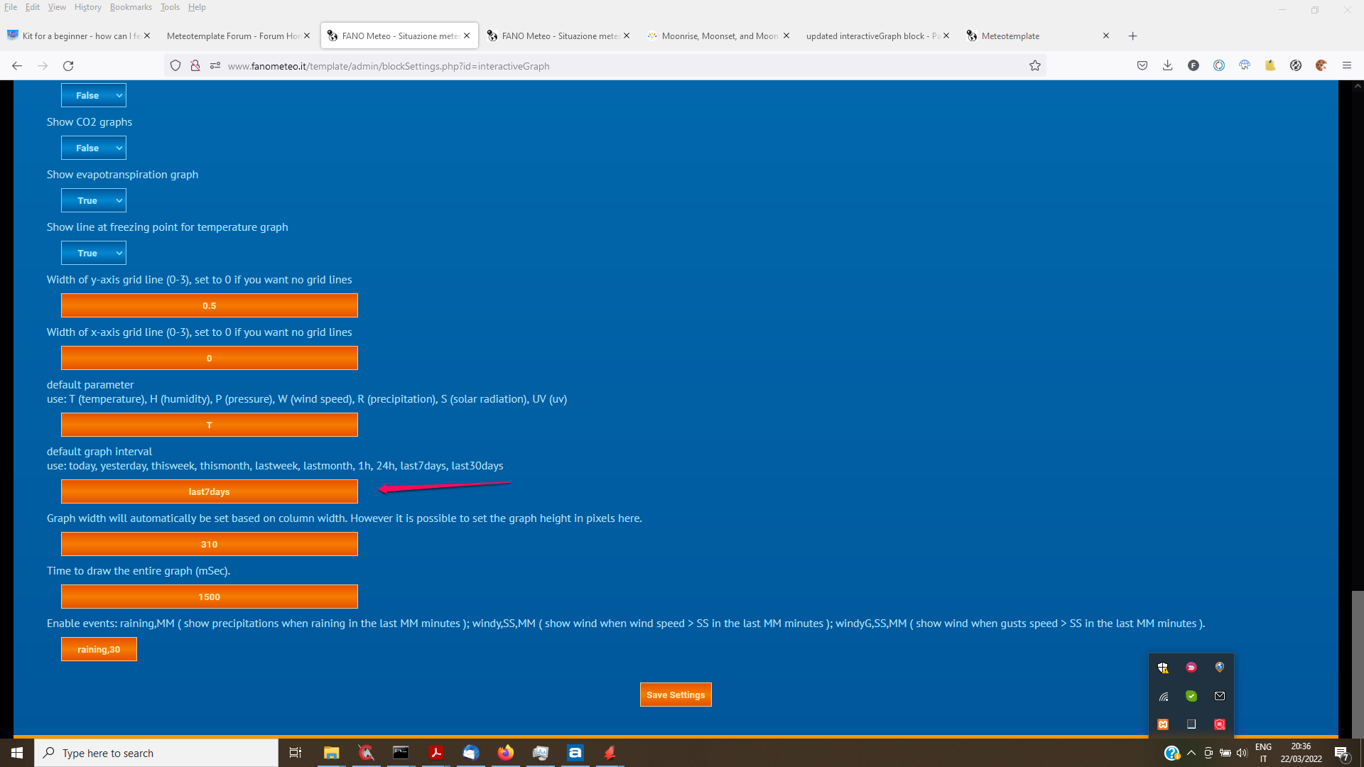

You could have a typo in the 'default graph interval' setting: last30days ( and not 30d )

You could have a typo in the 'default graph interval' setting: last30days ( and not 30d )/quote]
It was indeed, explains why I saw data in the graph until 2011,

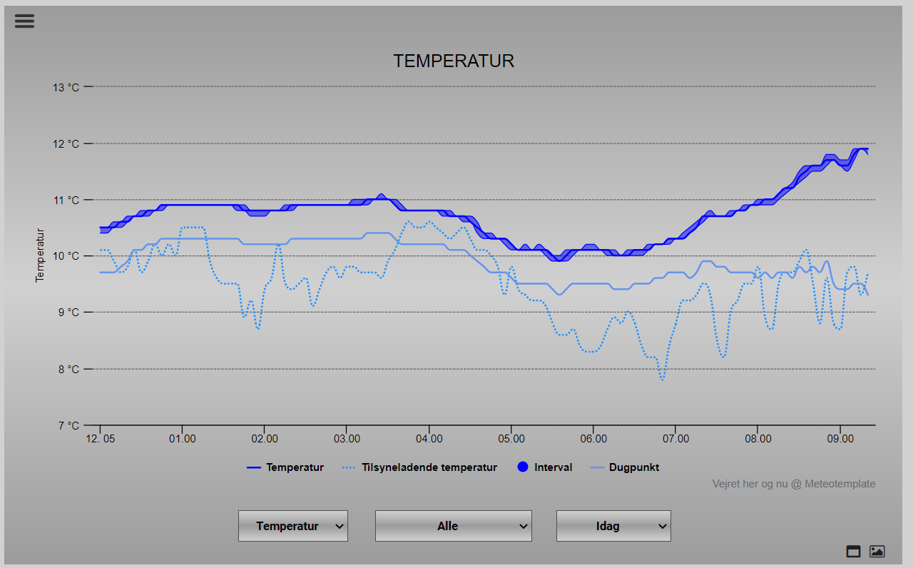

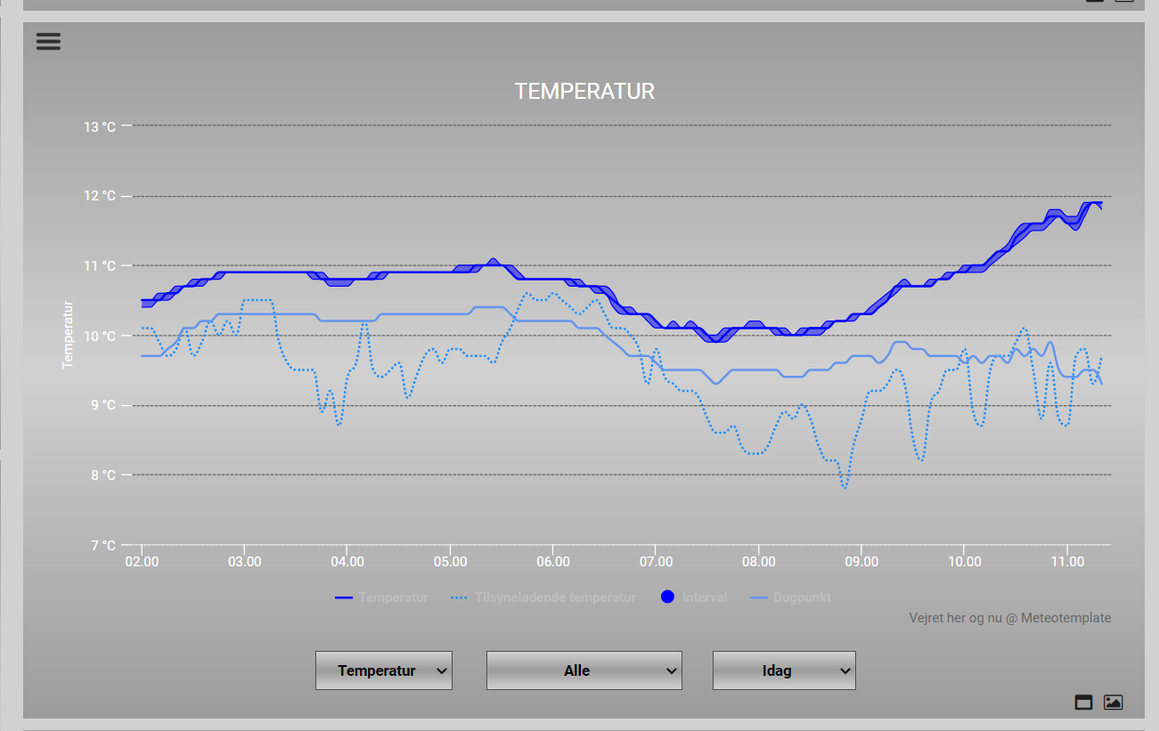

Hello
I have a problem with the interactive graph.
When opening my page the time on the graph is two hours ahead of the actual time.
(today starts at 2)
Data is correct in the database.
FireShot Capture 097 - Vejret her og nu - https___vejr.arloese.dk_template_indexDesktop.php.png
FireShot Capture 097 - Vejret her og nu - https___vejr.arloese.dk_template_indexDesktop.php.png (95.51 KiB) Viewed 74247 times
If i then select the 3 bars in the upper left corner of the block (menu option)
and select interactive graph it loads correct (and in the correct backgraund color)
FireShot Capture 098 - Vejret her og nu - https___vejr.arloese.dk_template_indexDesktop.php.png
FireShot Capture 098 - Vejret her og nu - https___vejr.arloese.dk_template_indexDesktop.php.png (86.54 KiB) Viewed 74247 times
I can not figure out how to get it to load correctly in the first place (anything to do with high chart, Denmark is 2 hours ahead of UTC i the summer)
Thanks for the updated block, really good work.

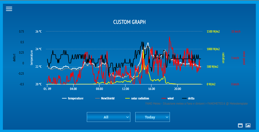

Is there already a method to have 3 Temperature sensors (T,T1,T2) show in one graph?
And how do I designate sensors (T1, T2) to the correct numbers for the colors/names?

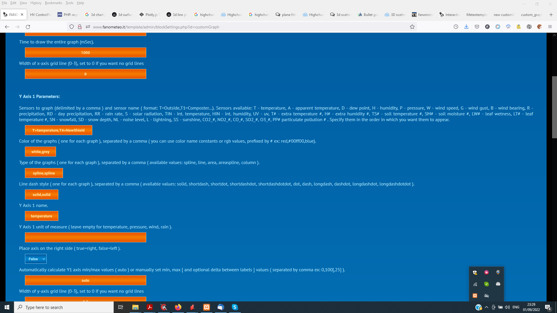

Re: updated interactiveGraph block
Post by davidefa » Thu Sep 01, 2022 9:46 pm
You can use the customGraph block, it can show any sensor on a maximum of 4 different Y axis.
For temp only sensors you need to set the initial parameters ( Y axis 1 parameters )
This is the configuration I use for the first axis ( simply add the third temp sensor in the highlighted fields )
You can also do a 'little of math' if you need ( for example I defined the fourth axis as: T-T4=delta

Post by Julius » Fri Sep 02, 2022 11:39 pm
davidefa wrote: Thu Sep 01, 2022 9:46 pm You can use the customGraph block, it can show any sensor on a maximum of 4 different Y axis.
Sorry, I don't understand your explanation here.
If I have 3 sensors, T,T1,T2 that I want to show in one graph, how do I enter its values?
See the customGraph in the center here; It's really strange, the time on the horizontal axis is incorrect (it shows the future?).
Also, the naming of the colors under it is in km/h (probably mingles with code from windrose?)..
georg wrote: Thu May 12, 2022 7:50 am Hello
(today starts at 2)
I have exactly the same issues, but with customGraph. Looks like a style naming convention issue interacting with another block (windRose?).

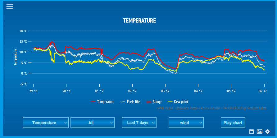

I really like this latest version of the interactivegraph block, esp as in brings in the extra sensors.
I have a couple of questions, sorry if they got answered before and I didnt notice.....
1: the titles of the graphs display in uppercase, is there a way to change this?
example, from TEMPERATURE to TEMPERATURE or from WIND to WIND
Reason for asking is the other blocks I am using all display the block title in the latter style, so I would like it to be consistent.
2. Some of the graphs have several items displayed
example 1 TEMPERATURE shows: Temperature, Apparent Temperature, Range, Dew Point.
example 2 WIND shows: Wind Speed, Wind Gust, Bearing
I am not so interested in Range and Dew Point in example 1 and Bearing in example 2 displaying on the chart display.
I know I can turn these items "off" or to blank by clicking on them, but I would prefer to have the chart to be without these items showing to start with.
Thank you in advance for your help.

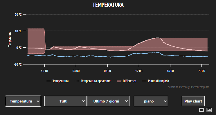

Post by marcom78 » Thu Jan 16, 2025 7:55 pm
Hi all
is there any possibility to remove the max-min highlited red area ?
