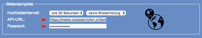

I don't know how the data is beeng updated. I have the database connection which I aded in the Mainsetup. When I test the Databaseconnection, I get the message: Your MySQL is currently set up correctly.
But where this data is written I have no idea. Yes off course I would preffer live data. Where should I change that?
I get an error message from Meteobridge.

what is the URL you used in the MB setting, the screenshot is cropped, I cant see it

Post by stadelhofen » Thu Nov 02, 2017 10:45 am
Re: Offline
Post by Jachym » Thu Nov 02, 2017 11:00 am
I think the problem might be in the https because if I run the API manually, it works, but seems like MB is not calling it
