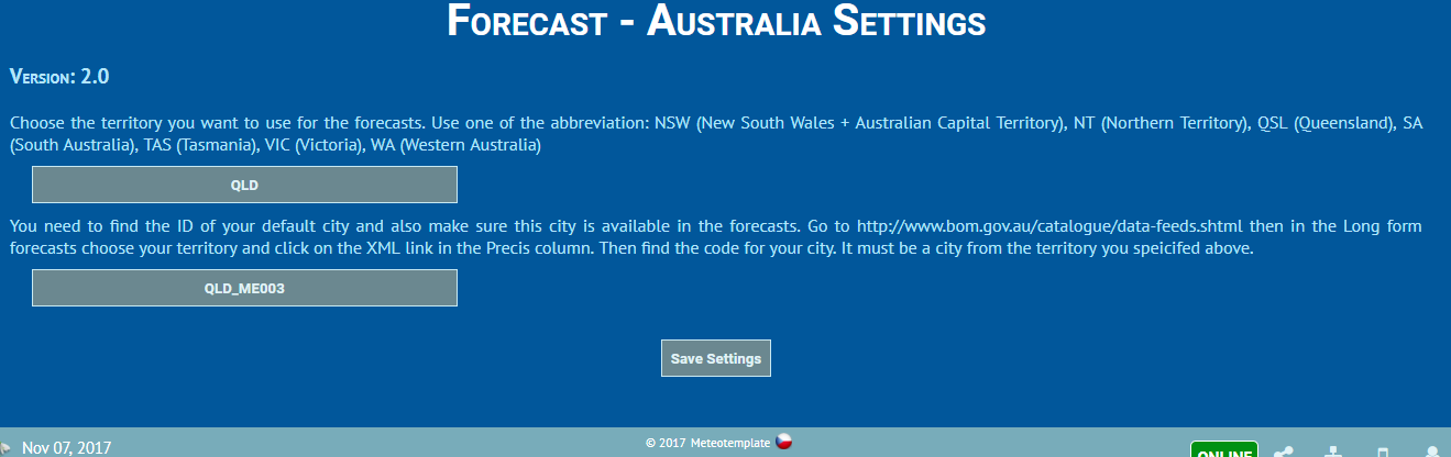

as per screenshot Queensland is represented by QLD but on the forecast its QSL
IF I enter QLD or QSL the forecast always defaults to NSW
also tried TAS as well still stuck on NSW towns
PS NSW, TAS and QLD are states (regions)

Whenever you make such change make sure you delete the cache file, otherwise it will be loading the original cached data until the cache expires (usually a few hours)

The abbr. for Queensland to be used is QSL I checked the block code now, but make sure you also delete the cache
