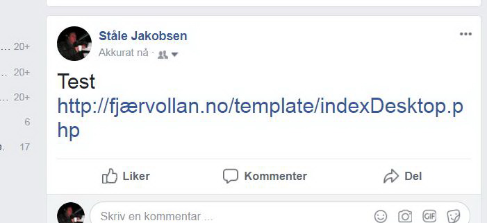

Post by tobydude » Sat Jan 27, 2018 7:26 pm
Hi.
When I post the URL of my meteotemplate website on Facebook,
there is no image with the URL.
Any ideas why?

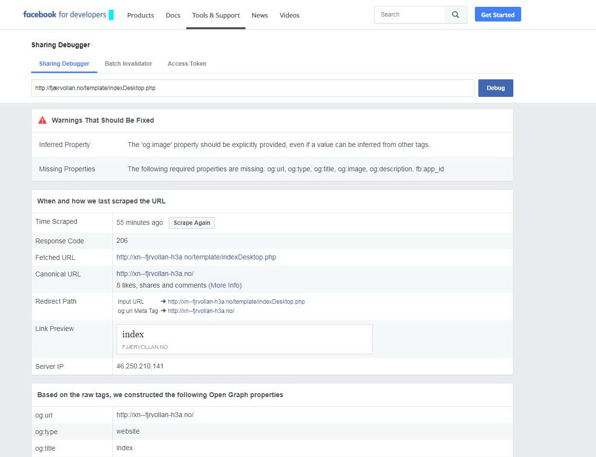

Post by tobydude » Mon Feb 05, 2018 1:11 pm
Asked my ISP.
They said : Try facebook debugging.
Did´nt told me much.

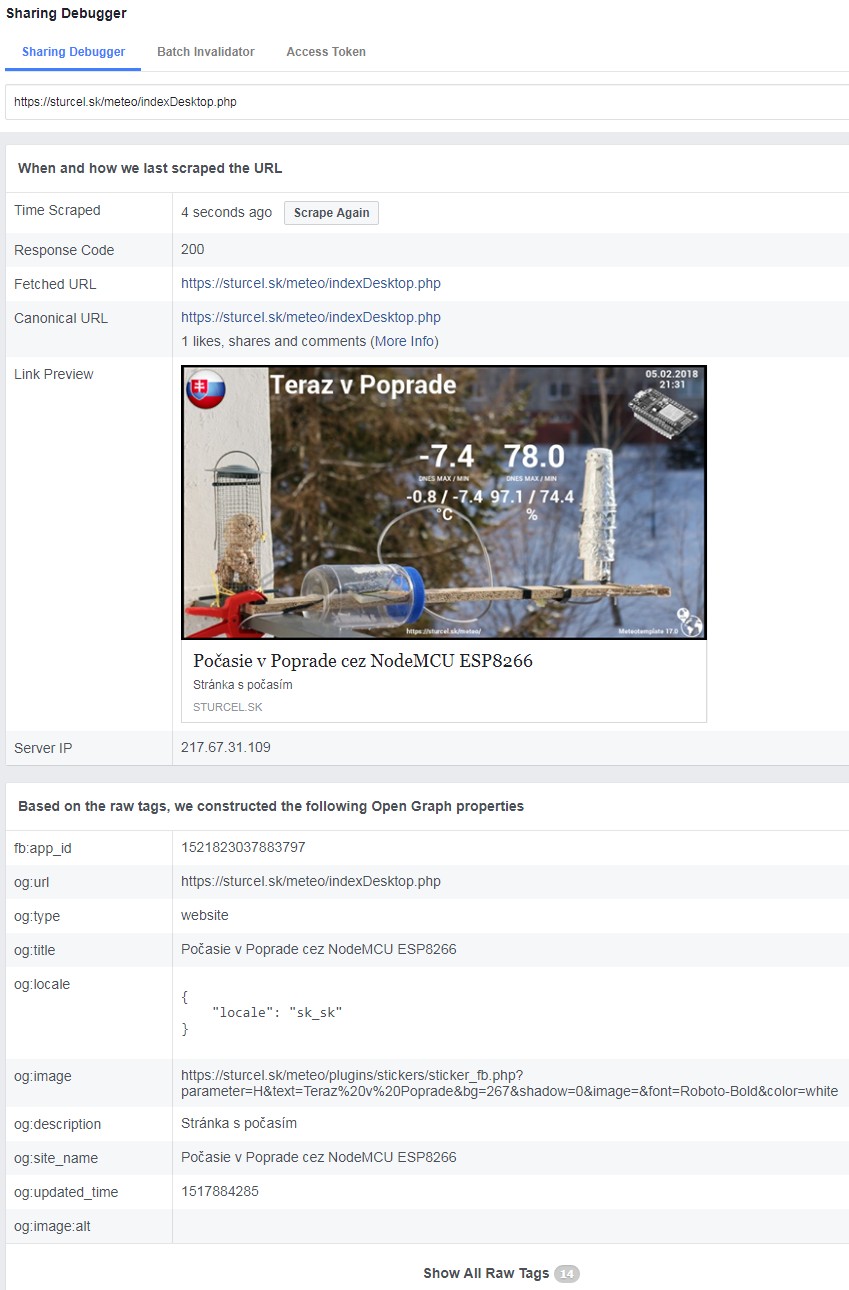

Post by mpca86 » Tue Feb 06, 2018 2:35 am
tobydude: in a similar sense I wrote here: viewtopic.php?f=55&t=1120
Now output from Facebook Sharing Debugger looks like this:

Post by tobydude » Tue Feb 06, 2018 10:19 am
tobydude
Posts: 206
Software: Weatherdiaplay
Re: No picture on Facebook
Post by tobydude » Tue Feb 06, 2018 7:36 pm
Is there any place in the index.php I can fill in metatags?
The following will be treated as a redirect by the crawler:
A HTTP redirect
A <link rel="canonical" href=".." /> tag
A <meta property="og:url" content=".." /> tag

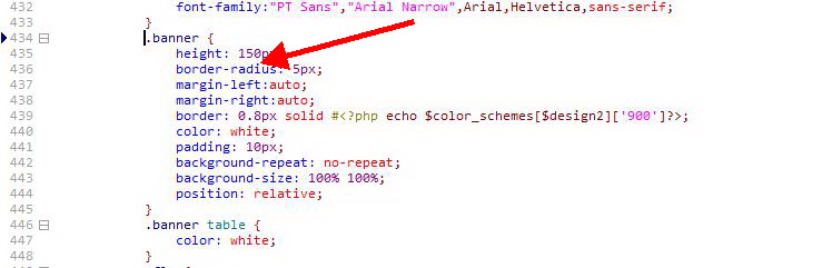

Post by Jachym » Fri Feb 09, 2018 9:50 pm
mpca86 wrote: Fri Feb 09, 2018 9:45 pm OMG,, just read the code a little...
For example, put it between lines 435 and 436....
MPCA86 - please stay polite, not everyone knows how to code
tobydude - keep in mind that unless you know exactly what you are doing things can go seriously wrong and what I always say is that everyone is free to modify the code, but at that moment Im no longer able to help them because making changes directly in the code means I no longer know what could be wrong

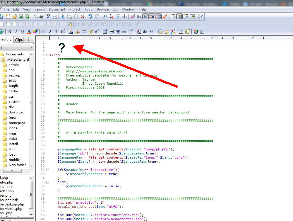

So, I can put a "html" kode in the middle of a .php-file?
Here:
Post by Jachym » Sat Feb 10, 2018 8:00 am
Im not sure what you are trying to achieve, Im afraid you will have to do it yourself, keep in mind that unless you really know PHP, HTML and CSS well it is a risky operation. Also keep in mind that making changes locks you out of updates because if you perform the update your changes will be reset, or you will not update which means you wont get any new functions released in upcoming versions

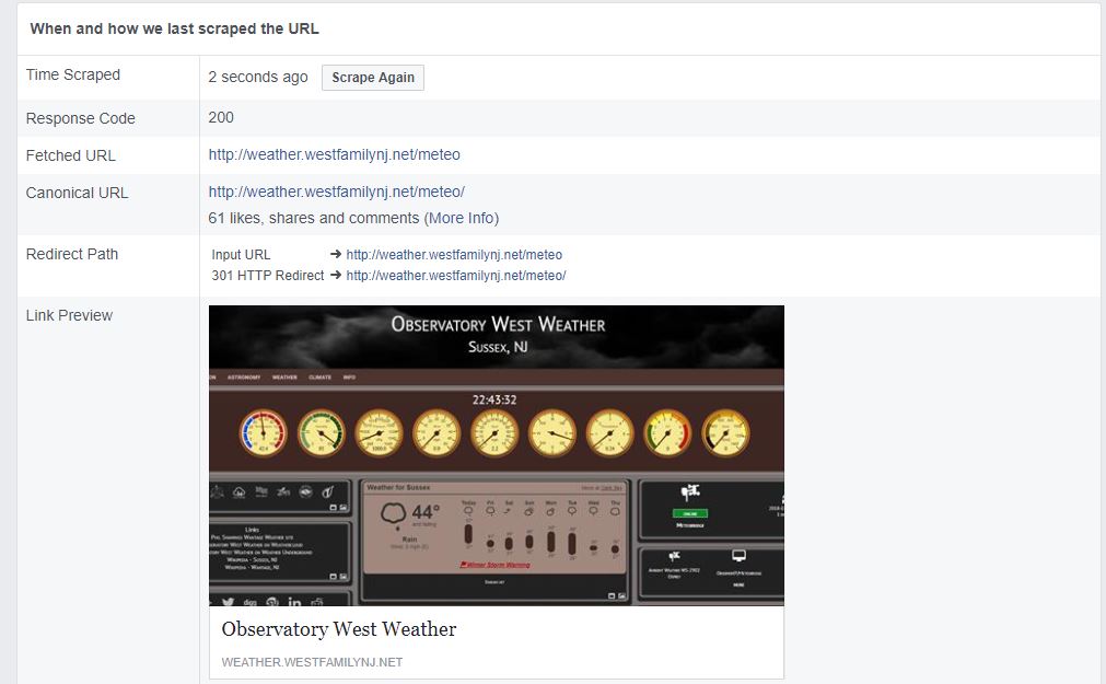

Post by MJW » Tue Mar 06, 2018 1:24 am
I'm not sure if you ever solved this or not, but what I did was on line 1 of index.php added the following -
<meta property="og:image" content="http://westfamilynj.net/ObservatoryWestWeather.JPG" />, and then my preview image shows up.
Here is what Facebook debugger shows.
fb debugger.JPG (72.55 KiB) Viewed 26286 times
I have the manual changed documented in the Admin Notes section of my site.
Good luck!
