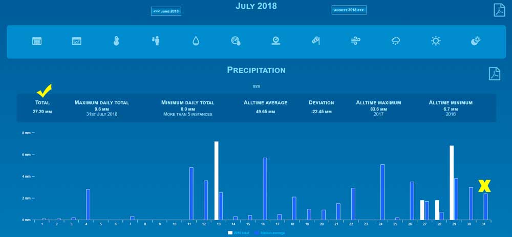

Post by Sperry Russ » Wed Jul 04, 2018 6:18 pm
I just discovered while importing and checking some data that every month that has 31 days the rain data is missing on the bar graph. It shows up below the bar graph in the detailed info.

As far as I know it is not a block or plugin. Just part of the template.
Go to the menu, then click Weather Station, then click Reports. Under the Monthly Reports choose the month and year, click Ok. Then click on precipitation. Then scroll down the page.

I've noticed the exact same problem from 9.6mm of rainfall we had on the 31st July 2018, it shows in the total and in the detail below the graph, but no bar appears on the graph.

I found the pesky bug. Change line 1163 of pages/station/reportMonthlyLoad.php from
for($i=1;$i<$numberDays;$i++){
to
for($i=1;$i<=$numberDays;$i++){
It's just a '<=' sign!
There's also another identical change at line 1280 which will add the 31st of the month to the range bar charts on temperature and other variables.

Hi Jon, thank you - it worked. I've know idea how you found that one character missing in all those lines of code, but it's done the trick.
