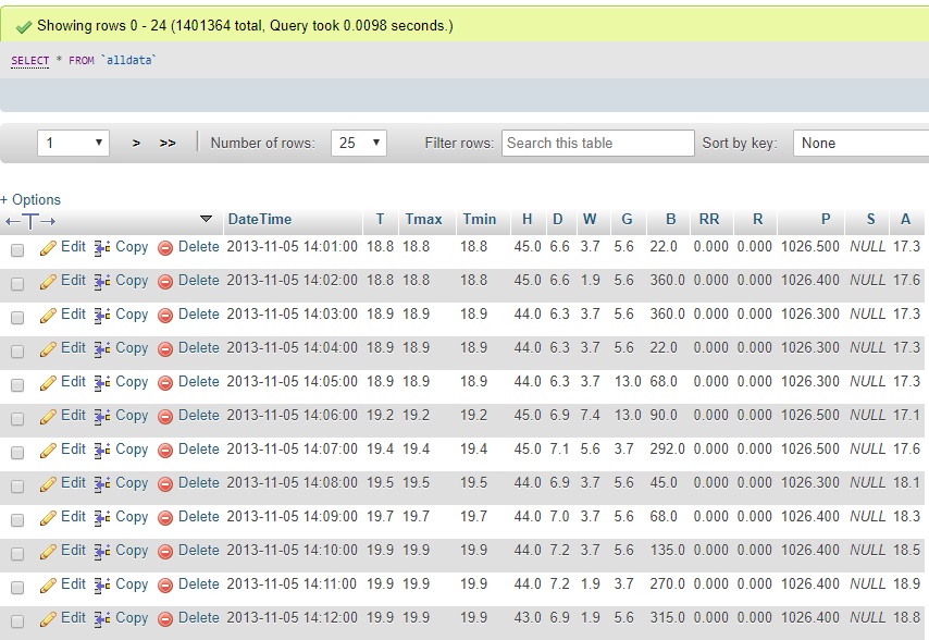

A small (hopefully) image of part of the database is attached.

I would check if this block is using cache. If yes, clear the cache.
Btw. You better should convert your database to 5-minute samples.

Also as Luc pointed out, you need to reformat your db, dont use one-minute intervals, it will introduce inaccuracies to the statistics because the template assumes a 5-min db (not to mention that your page will be very slow over time)

The db I would swear I had done the conversion ages ago - in fact I remember doing it twice, as I couldn't recall whether I had done it at all (too lazy to go looking at the data base itself). :)
