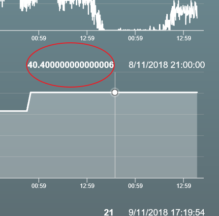

It's not alone in my json-file i am getting also ridicilous numbers on my site, see example in attachment...

Thank you for your answer!

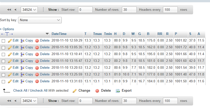

This is an excerpt of my database, seems to be OK or am i missing something…
Any suggestions of course welcome!

Hi!
The database looks fine I guess.
It's necessary to go back an other step and check how the data are presented by the originator (WU, meteohub, meteobridge, etc.)
For example, an analysis of the clientraw.txt or other specific data files could be a good idea.

Re: ridiculous amounts of decimals behind my comma?
this most likely due to Javascript calculations. For some reasons of how it works, it sometimes makes these ridiculous numbers when converting units (doing some sort of calculation in general). It is very unpredictable, so far I wasnt able to find how to fix this, but there are many questions about it on the internet. I tried using the toFixed command in JS, but with no luck either.
