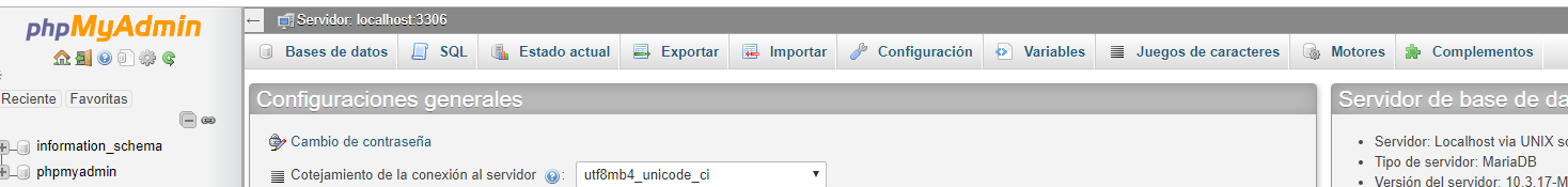

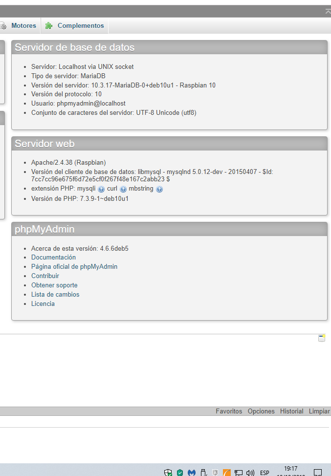

I'm sorry I'm still stuck.
I can't find the "Privileges" tab in my phpMyAdmin.
To access I use:
user name = phpmyadmin
password = yomismo
In the different installations I've done (no less than four) using the command sudo
apt-get install phpmyadmin
and, I only chose Apache2, I said yes to dbconfig-common and set the password to "yomismo". It didn't give me the option to choose a username.
Perhaps I could run this command
GRANT ALL PRIVILEGES ON php-myadmin.* TO 'javier'@localhost IDENTIFIED BY 'viva';
But where is the tab for granting privileges?

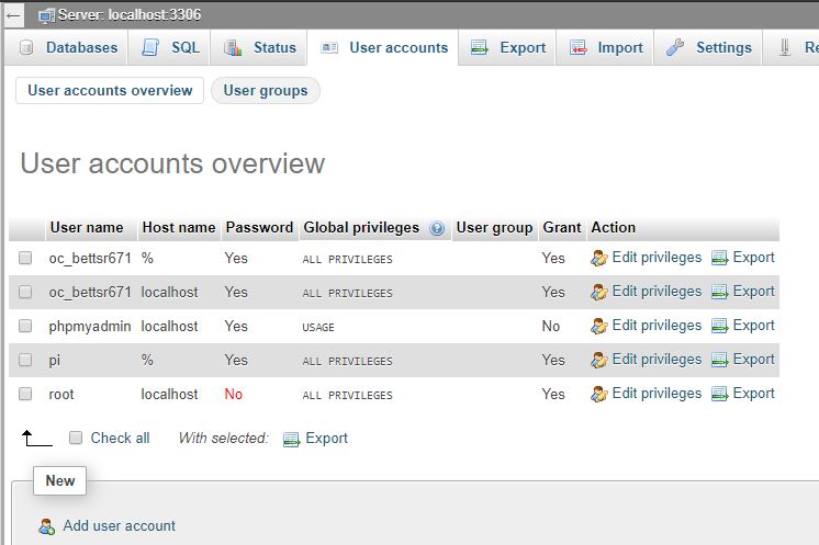

User Accounts >> Edit Privilege's >> Select All >> Go Button to save. it's at the bottom right side you may have to scroll to see it.

I must be blind, but I am not able to see "User accounts". Would it be possible to use the MariaDB terminal?

You should see it here. If not, that user account you login with does not have enough privileges probably.

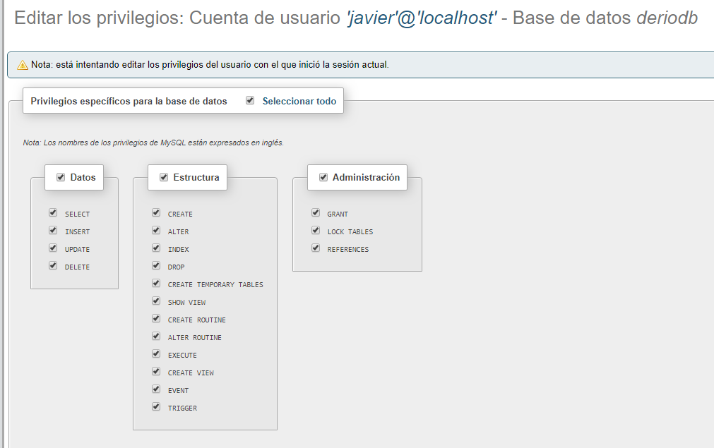

I think I made it.
From the MariaDB terminal I have executed these commands
grant all privileges on *.* to 'javier'@'localhost' with grant option;
flush privileges;
Now, miraculously, I get the Users tab and the ability to edit privileges.
I'm so happy that I haven't made the necessary checks yet. :D :D :lol: :lol:
I will inform you of the results when I do all the checks rigorously.
Thank you very much.

Post by El_Viejo » Fri Oct 11, 2019 6:13 pm
Here's the proof.
Tomorrow I will check that in the MySQL section of the template the check is correct.
It is wonderful to find people like you, willing to dedicate their time to help inexperienced people like me.
