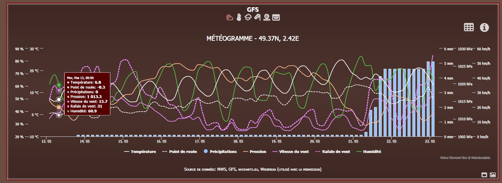

Hi, GFS has some problems, does not show the map, the meteogram is probably rain as a sum of rainfall, others works GFS block normally, or is it just a mistake?

Hi, GFS doesn't work for me. It only shows the amount of rain that is constantly growing
and the map is not showing

hello, your progress does not help when I look at your site, I see the same problem, the map is not displayed and the meteogram is not seeing individual precipitation, but the summary

Thanks for fixing GFS, but I'm not satisfied yet, it still shows a summary of the rain, but not individual precipitation, as it was in the past, see the picture. Could it still be fixed? Thank you very much.
