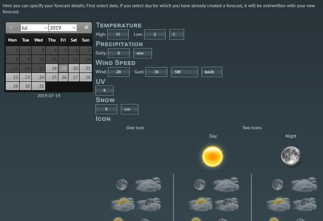

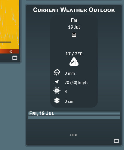

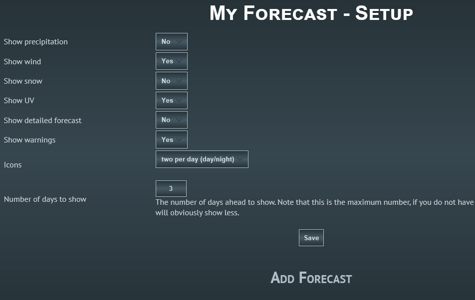

Can anyone help with the myForecast block, I've set it up, added my forecast but the icons don't appear on the weather page. www.dullstroomweather.co.za/template/indexDesktop.php

Finally sorted this problem out, I was filling out the forecast using Microsoft Edge and not Google and that is why the icon was not appearing on the webpage.
