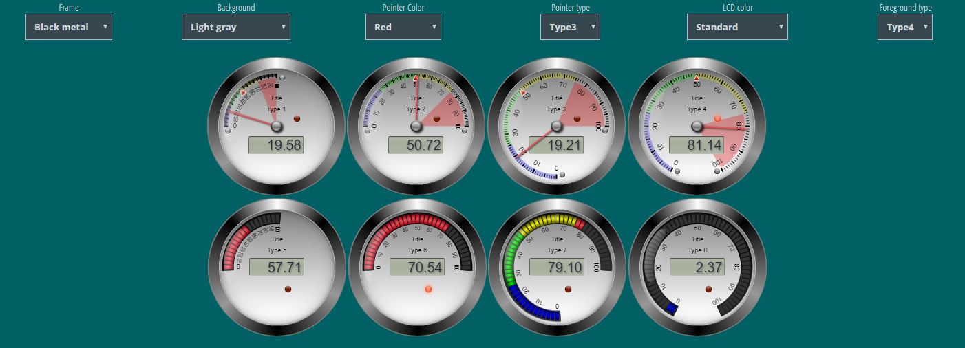

Yes I had changed a few of the settings so I just went back and changed a lot more of them but I am not seeing any changes yet.
