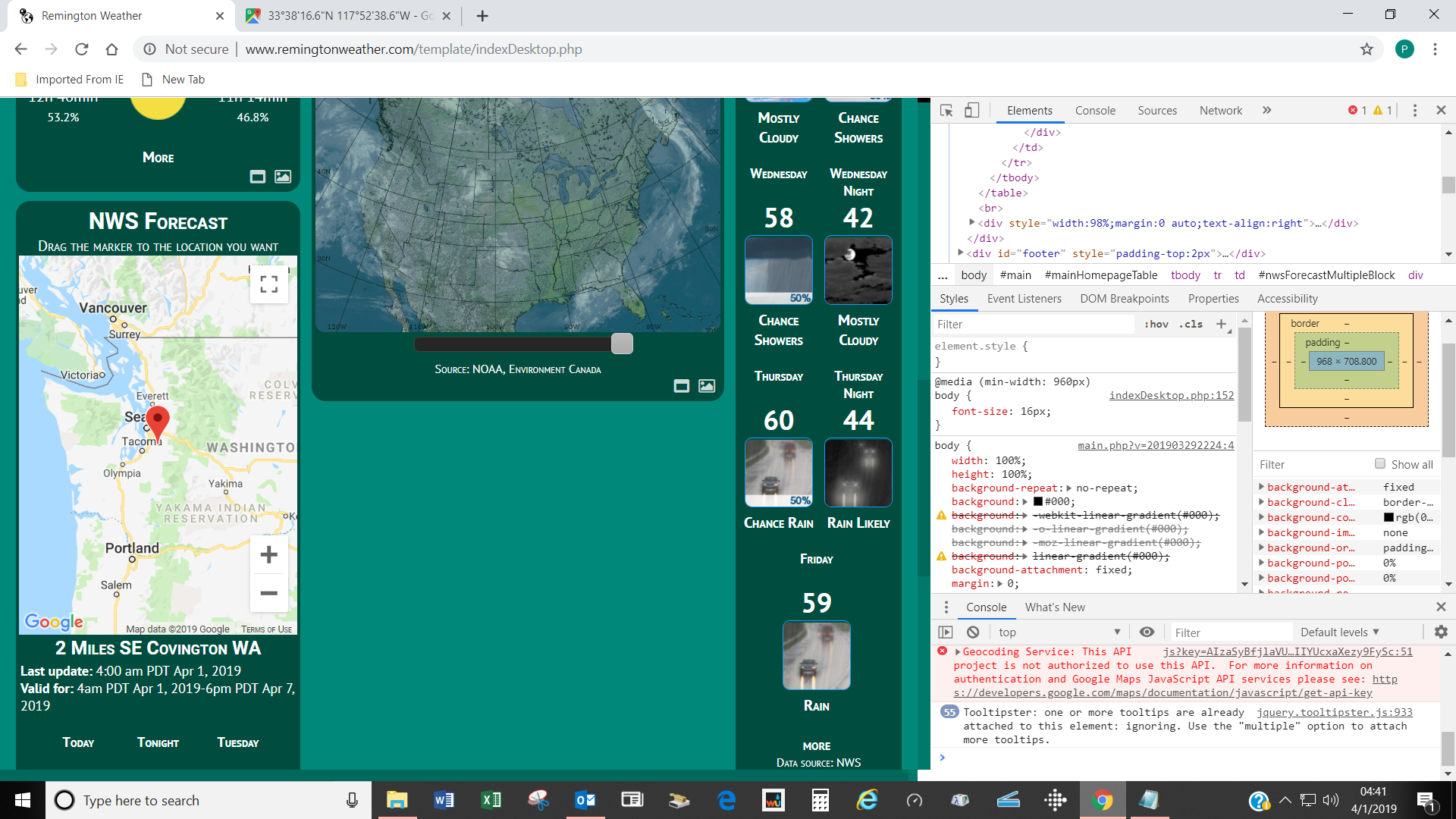

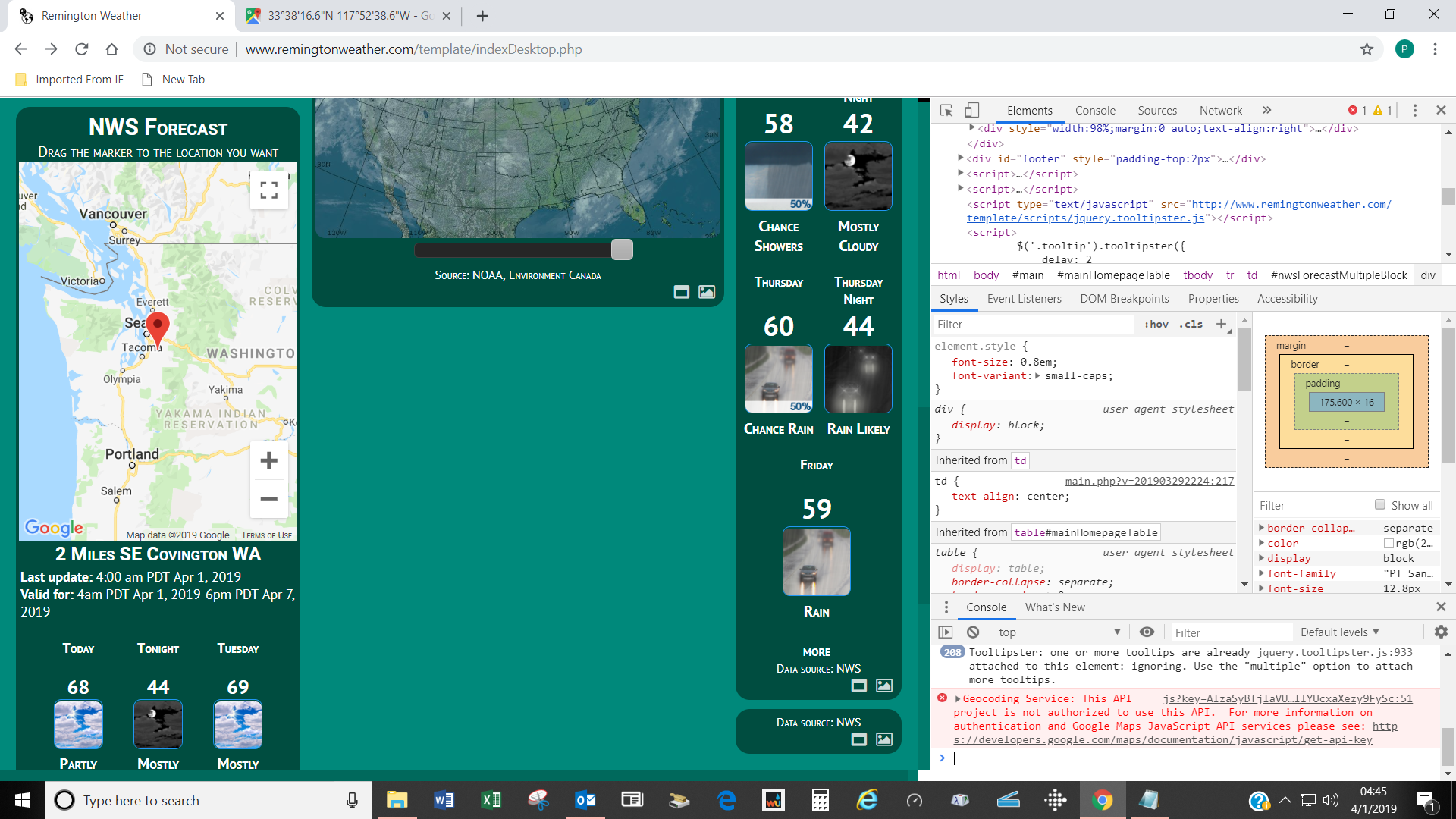

Hi Everyone,
First post!! Great stuff on this forum but can't seem to find the post that will help.
After making sure the nwsForecastMultiple block is correctly installed on homepage and setup configured, I don't get the requested forecast coordinates weather. I've gone as far as I am capable to find the error. See the screenshot for the potential problem. Not sure how to fix it. Any help would be appreciated.
http://www.remingtonweather.com/templat ... esktop.php
Thanks ahead of time.
Paul
Paul
- Screenshot (92).png (711.47 KiB) Viewed 24088 times
- Screenshot (91).png (837.84 KiB) Viewed 24088 times

Re: nwsForecastMultiple not working
Dave,
Thanks for checking. Could send me a snapshot of my homepage. This is what I see.

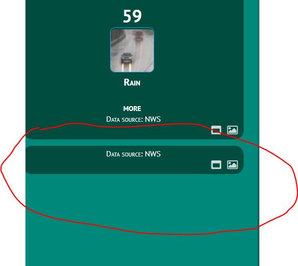

- Posts: 433
- Location: OKLAHOMA, USA
- Station model: Ecowitt WS90
From what I am seeing now... you are using the same blocks... one in the upper right and one in the lower left. As far as I know you can not use the same block twice in any part of your setup. I am not using the multi version but have added it to the bottom center of my site for testing and it is working fine for 3 sites. I believe again that you can not add the same block twice. Try removing either the bottom left or top right and try it again. Look at my site as a reference for the next 24 hours.
Andy
Andy
- Posts: 433
Can you post the lat-long's of the area's you wanted to post weather for?
- Posts: 433
The block setup should look like the screenshot in default mode. Change the lat-long to the sites you want listed. if it doesn't work let me know.
Andy
