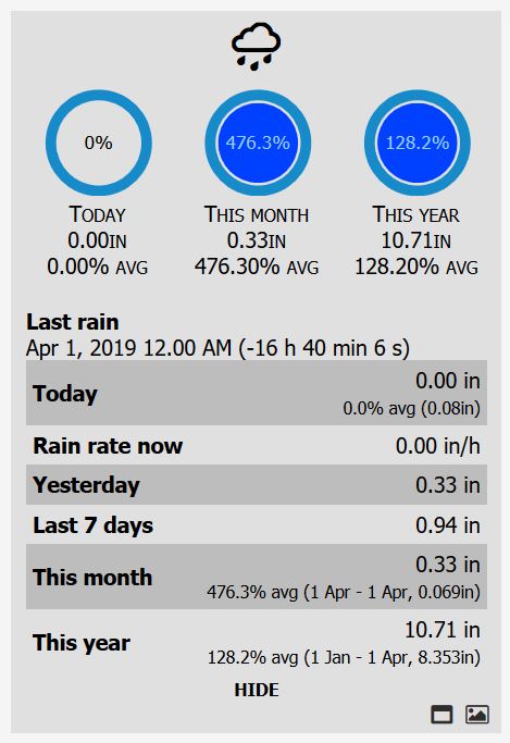

Precipitation that occurred on March 31, is shown as falling on April 1.
On 3/31 my station received .33" of precipitation. Looking at the data by Weather Station > Precipitation is shows that .33" of rain has fallen in April, which is incorrect.
I first noticed this by the odd display in the rain block. During the day on Sunday, my Meteotemplate pages were showing the correct amount of rain during the day. The rain stopped shortly after 6 PM on Sunday, yet the database shows that rain as falling the next day, yet the current conditions shows no precipitation for today, which is correct.

My suspicions were right. The first rain for April came on 4/5, when I had 0.20" of rain, ending at 9:35 AM, and there has been no rain since. Not sure why this occurs, but as it looks now I will have to manually edit that database the day following every day there is rainfall, or over 120 times a year.
My rain block now shows that 0.40 inches of rain has fallen in April. It also shows that the last rain was at Apr 6, 2019 12.00 AM.

This is what I see on my Weather Display main screen.
This is what the rain block shows as the same time on MT.
The single entry at 00:00:00 hours in the database that includes the previous days rain is the cause. Editing this single entry corrects everything as far as rain totals.
