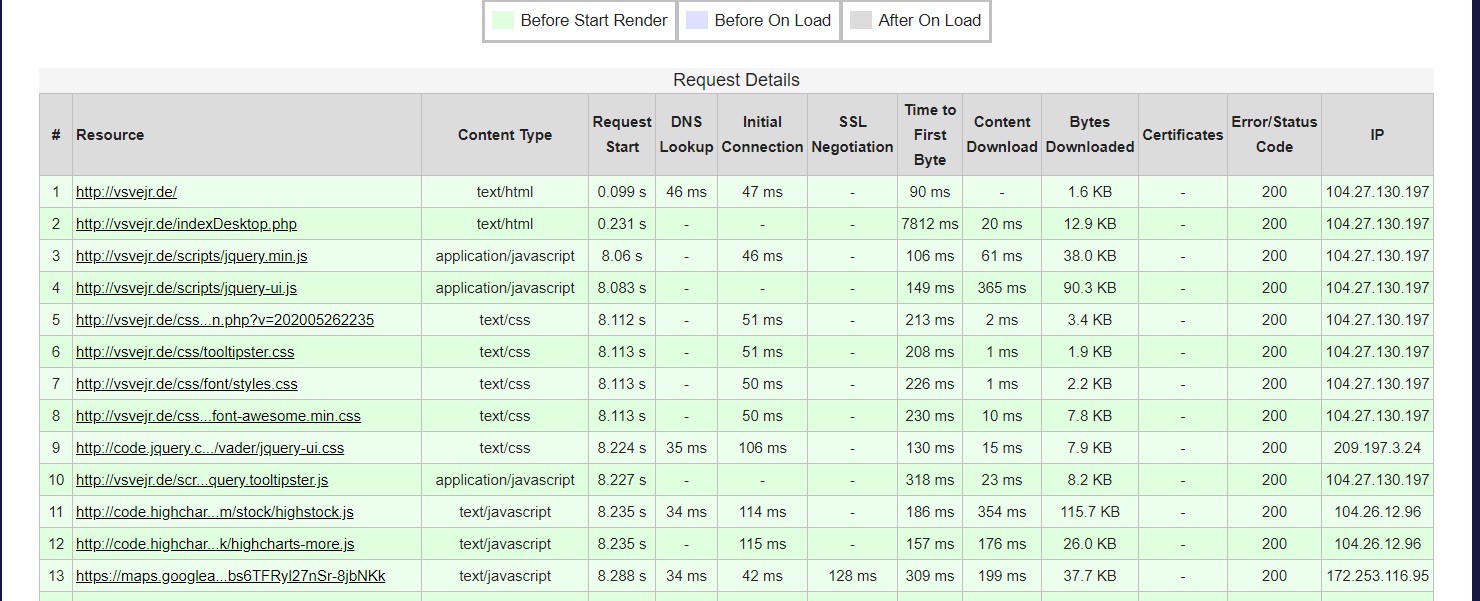

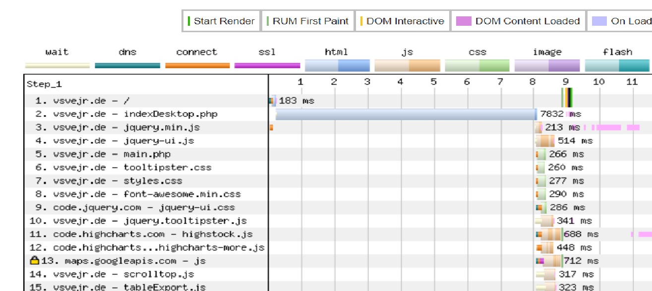

Hi
Time to first byte is around 8 seconds, as seen on the screenshots, when indexDesktop.php is called. So what is going on in indexDesktop.php? The mobile page loads very fast.
Furthermore, I have 3-4 blocks which also load very slowly
Anyone who can come up with good ideas where to look?
