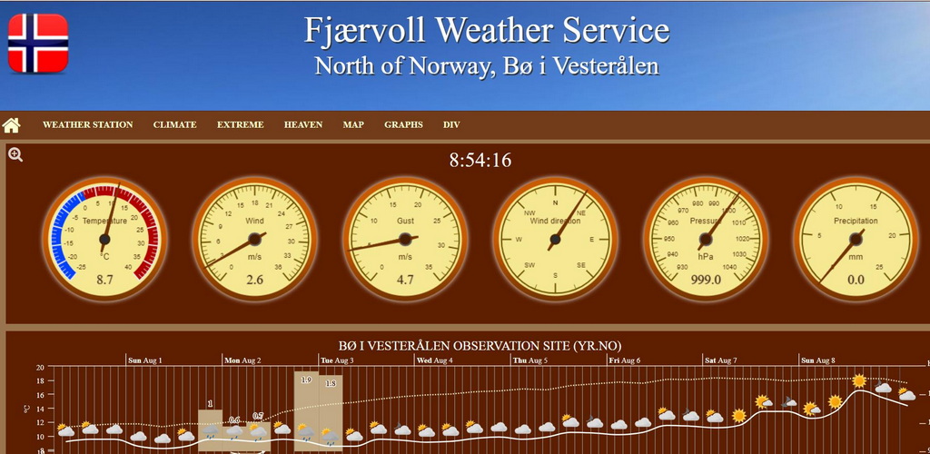

This is how it should look like:

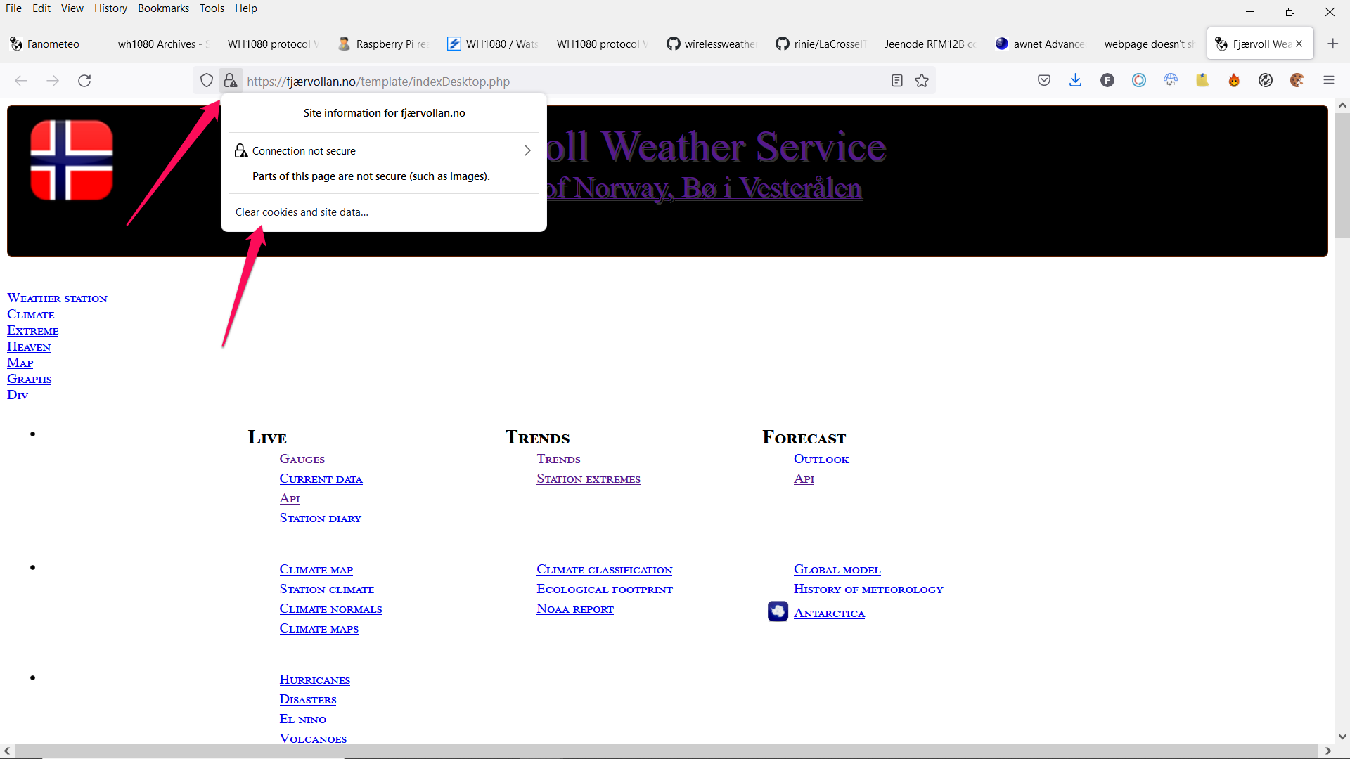

Post by davidefa » Sat Jul 31, 2021 10:16 pm
They should clear the cookies, cache and navigation data ( in firefox this is accessible clicking on the lock icon and selecting the last option )
I don't know why, but once you browse the https site, even if you browse to http site you'll be redirected to the https.
The only remedy I found is clearing cookies, cahche and navigation data.

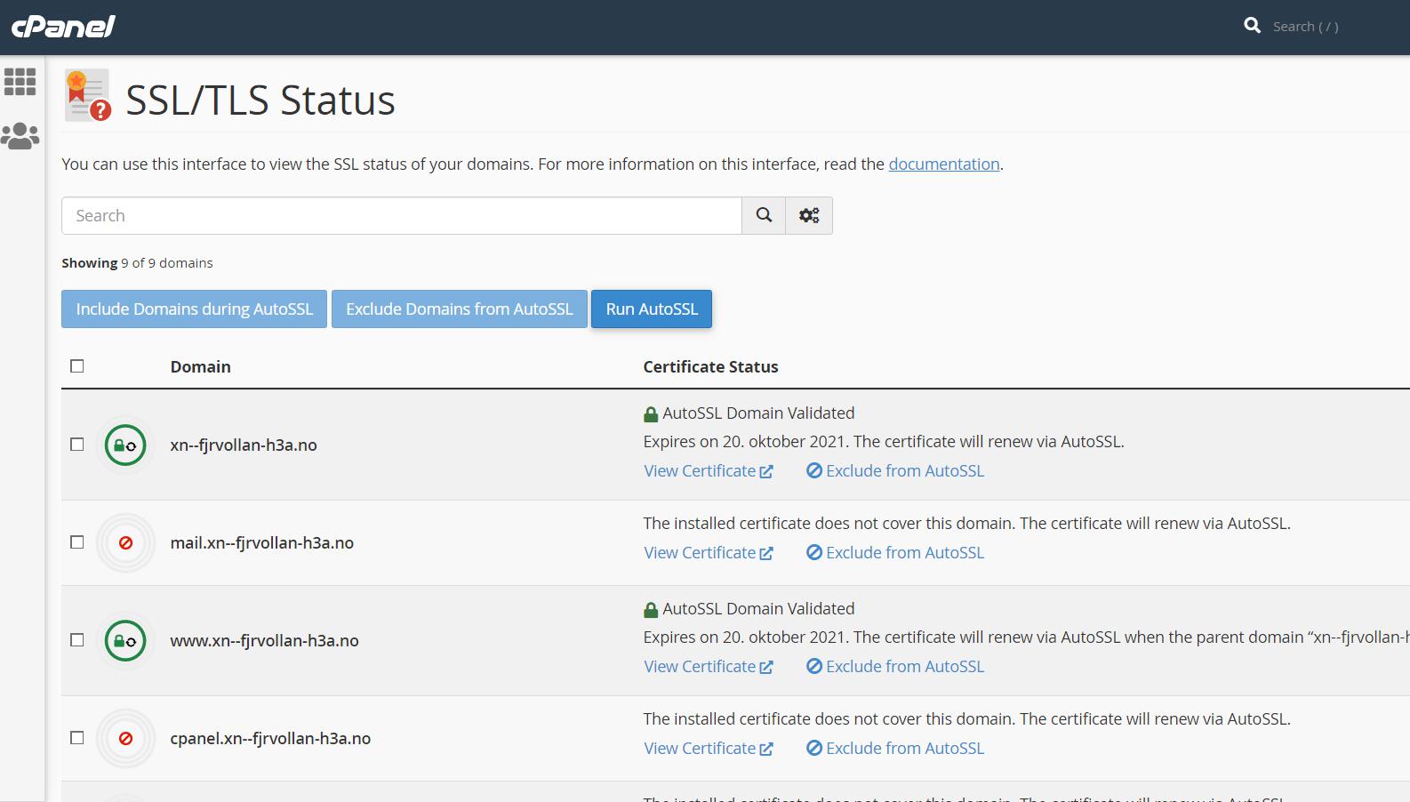

I guess it has to do with SSL/TLS on my host´s server. (PROISP)
I probable need support from Proisp on this issue.

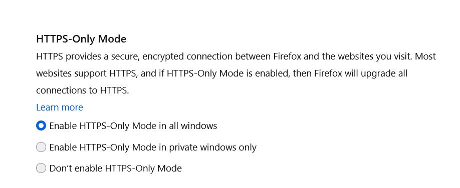

Also, when i allow "unsecure content" in Edge, it shows the page correct.
In Firefox when I set the browser to "HTTPS-Only Mode"

My host server "support" canged "Line 20 in config.php file from (HTTP --> HTTPS)to
$pageURL = 'https://xn--fjrvollan-h3a.no';"
And he sat a "redirect" so that visitors who use HTTP is redirectet to HTTPS.
Now, the weather page seems to work fine.
