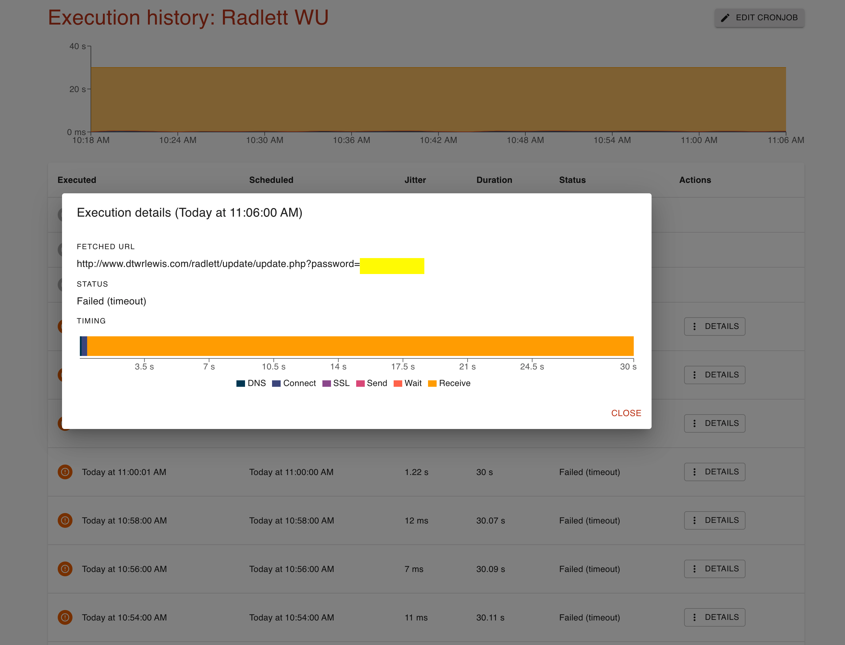

Having intermittent problems here http://www.dtwrlewis.com/radlett/indexDesktop.php. Database updates via WU IENGLAND417 - updated the WU APIKey - updated Meteotemplate to 18. It worked for 12 hrs then failed today. Strangely, even tho cron-job history says it failed at each attempt today - the home page seems to be occasionally updating with current data. Any ideas

JUst an update on this - my template stopped updating at 8.30 local time. All subsequent cron-job report fail. However the current conditions block is somehow still working. Wondering if I need to do a fresh instal? This is for my dad's weather station. Mine is on the same server ..../rothesay and updates via weathercat api - no problems

From your cache/updateLog.txt e cache/updateLog.txt I see that your cron job is sometime working ( 17:40, 21:30 and 21:46 ).
On my test pc I have no problem retrieving your data from wu using your station id and api key.
So I think the problem lies ( somehow ) in the cron job.

If everything works as expected try disabling the original cron job and set a new one ( you could use also a free cron job from https://cron-job.org/en/ just for testing )
Even if wu is now working ok, we don't know if this morning wu had 'a few hiccups' ( not very difficult to believe ) and the cron job gave up after repeated errors (check if you cron job has a detailed log of the failures )

Thanks davidefa. When I call the update.php manually it takes forever (2-4mins) to result in "success' page.
It seem to be a problem with the update.php
