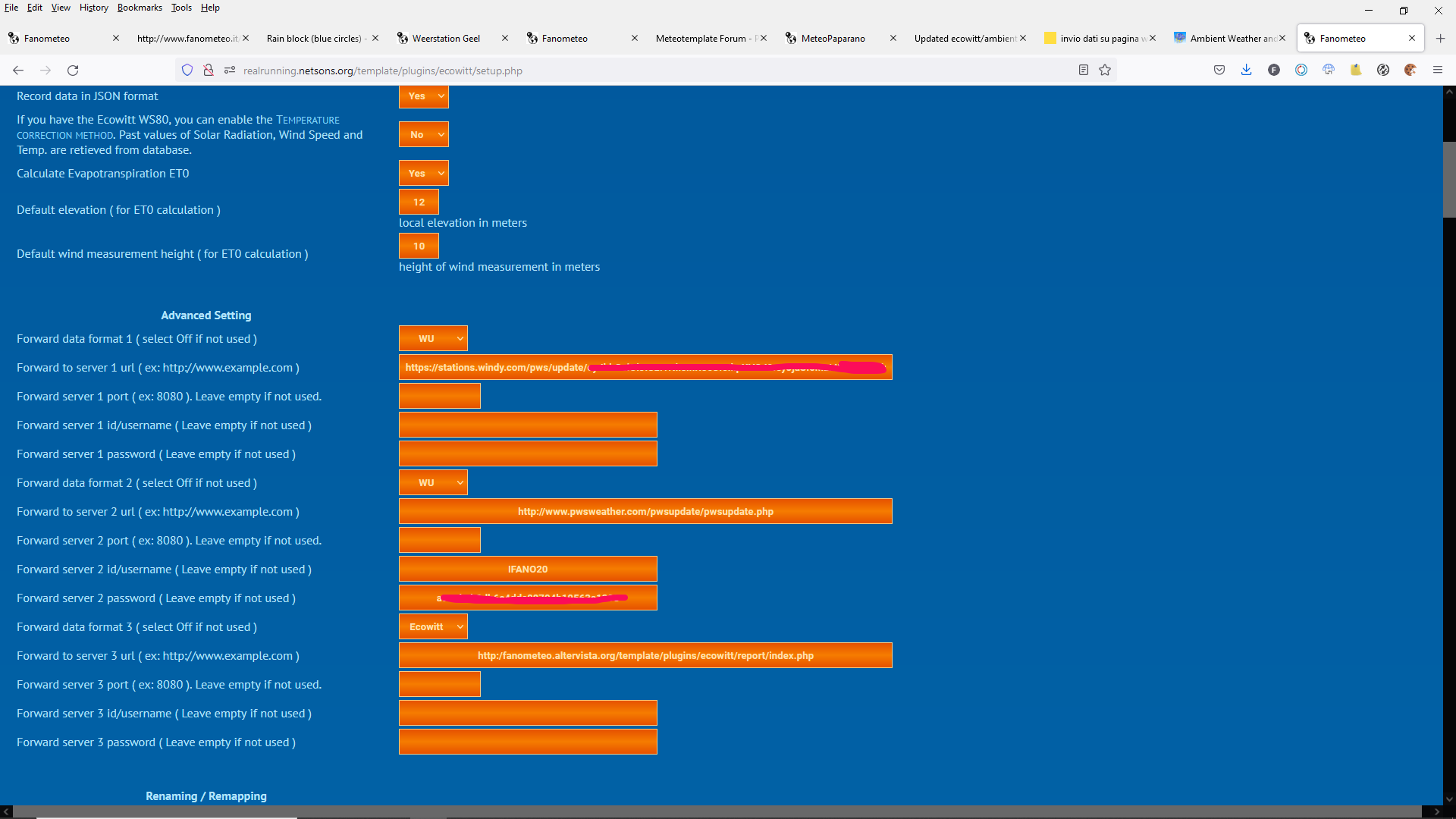

Hi Davidefa,
I have just updated WeatherNetworks Block, I couldn't help but notice the addition of windy.com to the settings. I have been registered to their site for years and with their development in beta are a nice step forward finally. But now, as an Ecowitt PWS owner, the problem has arisen on how to load data to windy automatically. Can you tell me if it is possible through Meteotemplate? Because from App Ecowitt Wsview Plus, in the Weather Services options, Windy is not unfortunately present and I don't even know if it will ever. I seem to understand that the ECOWitt protocol is compatible even in customized. Is the solution compulsorily a raspberry pi or meteorebridge?
Re: Updated weatherNetworks block
Yes, using the 'forwarders' of the ecowitt plugin.
For Windy:
In 'forward data format' select: WU
In 'forward server' set: ( substitute YOURAPIKEY with your api key ): https://stations.windy.com/pws/update/YOURAPIKEY
For PWS:
In ''forward data format' select: WU
In 'forward server' set: http://www.pwsweather.com/pwsupdate/pwsupdate.php
In forward id and password set your id and password
For WU:
In 'forward server' set: https://weatherstation.wunderground.com ... tation.php
For Windy:
For PWS:
For WU:
- windy.png (121.26 KiB) Viewed 13315 times

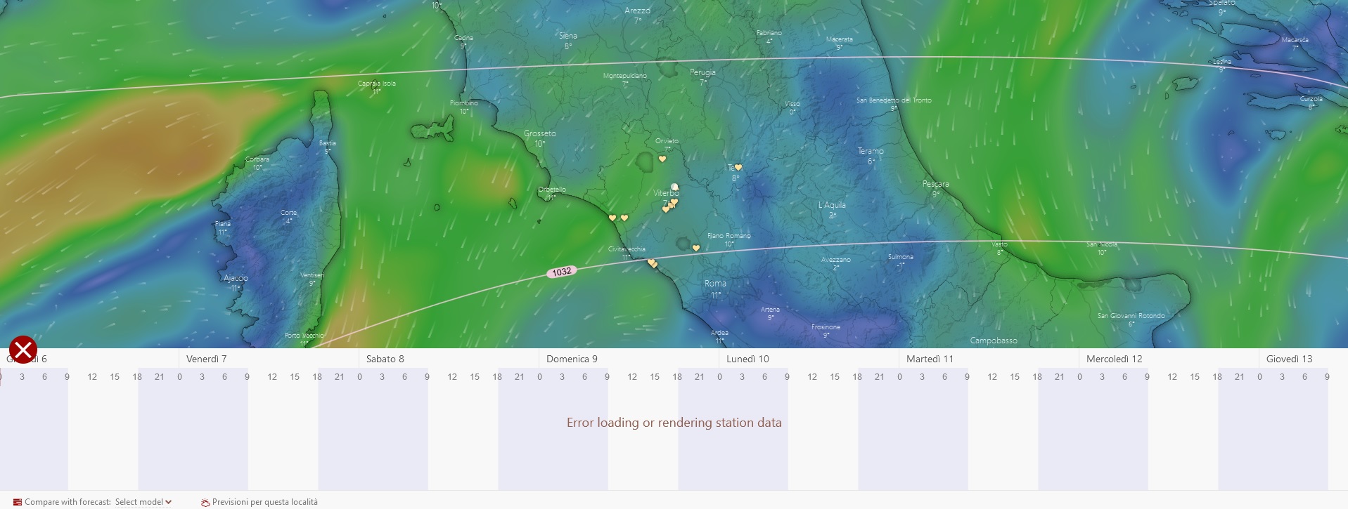

Now from Windy's link again reports "error loading or render station date", I assume it is due to the fact that there are few data but in a few hours I should see something, at most tomorrow.

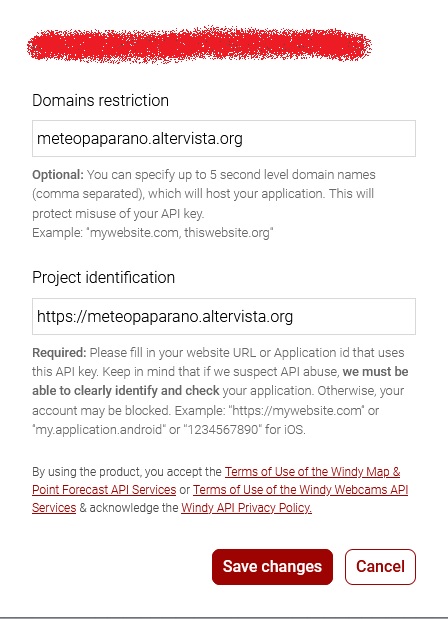

UPDATEdavidefa wrote: ↑Wed Jan 12, 2022 5:02 pm Yes, using the 'forwarders' of the ecowitt plugin.
For Windy:
I created Map Forecast API but, I still don't see anything unfortunately and I don't understand why. On the "Manage Your API Keys" page still reports "The Key Has Not Been Used Yet." And if I try to use the three "Get" methods to view the data
- https://stations.windy.com/pws/station/ ... station_id
- https://stations.windy.com/pws/stations/api-key
I always get "Invalid token".
Now I came to doubt if I entered the data in "create in New API Key" but I was very uncertain Sorry but sometimes I lose myself in nonsense
