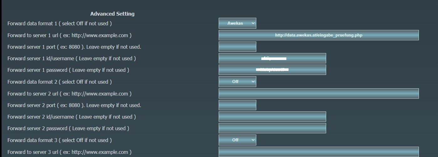

Hello, I recently bought an Ecowitt GW1100 to be able to eliminate the computer, in charge of uploading data from my weather station ( http://www.meteosantmateu.online/templa ... esktop.php ) to my website through the CumulusMX program.
After some failed attempts I have finally managed to upload the data to Meteotemplate.
With my old management program -CumulusMX- of the weather station, I was able to send data to Awekas https://www.awekas.at/es/instrument.php?id=10757, but now it is stuck with the latest data that I sent from CumulusMX and would like to be able to continue sending data.

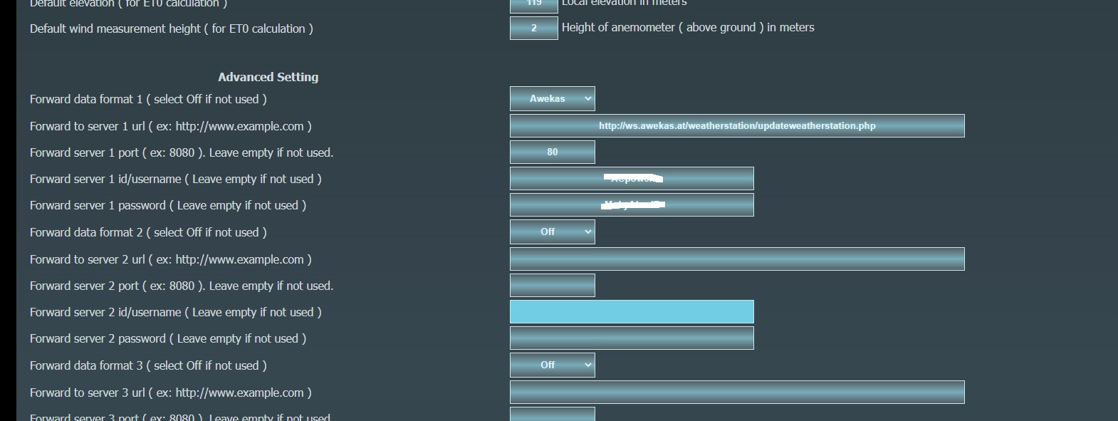

I have uploaded two screenshots of my Ecowitt plugin configuration and Awekas configuration and I don't know where the problem is so that it doesn't update data in Awekas.
Any help is welcome. Thank

In 'Forwared server 1 url' set http://data.awekas.at/eingabe_pruefung.php
Leave empty 'Forward server 1 port'
To check for error/problems take a look at cache/ecowittLog.txt

Re: Ecowitt plugin configuration

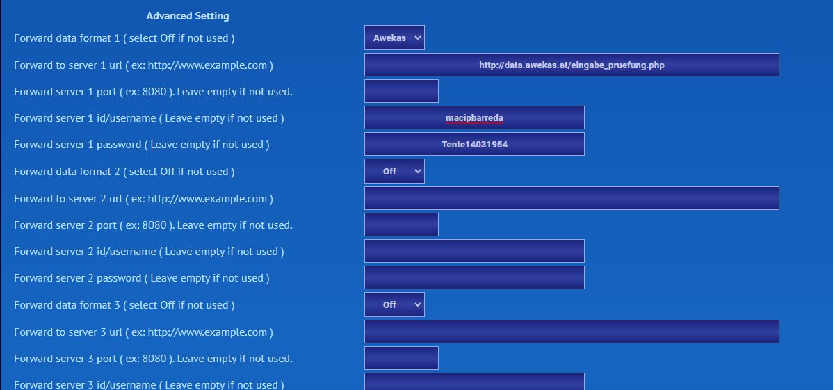

Hello davidfafa. It seems that thanks to your solution, my station sends data again https://www.awekas.at/en/instrument.php?id=17680#day. Attached capture with the changed data as well as the ecowittLog.txt file. Thanks

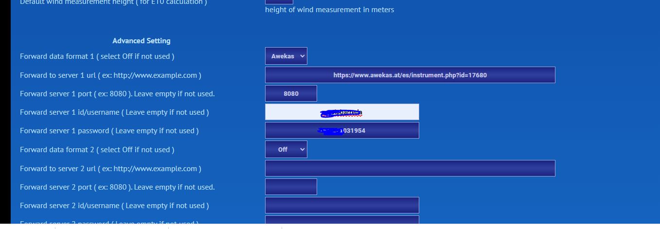

I have the same problem, I configured everything as described but nothing arrives on the Awekas site, I also tried another configuration found on the Awekas forum but the result is the same.
Thanks for your help
Ale
Ale

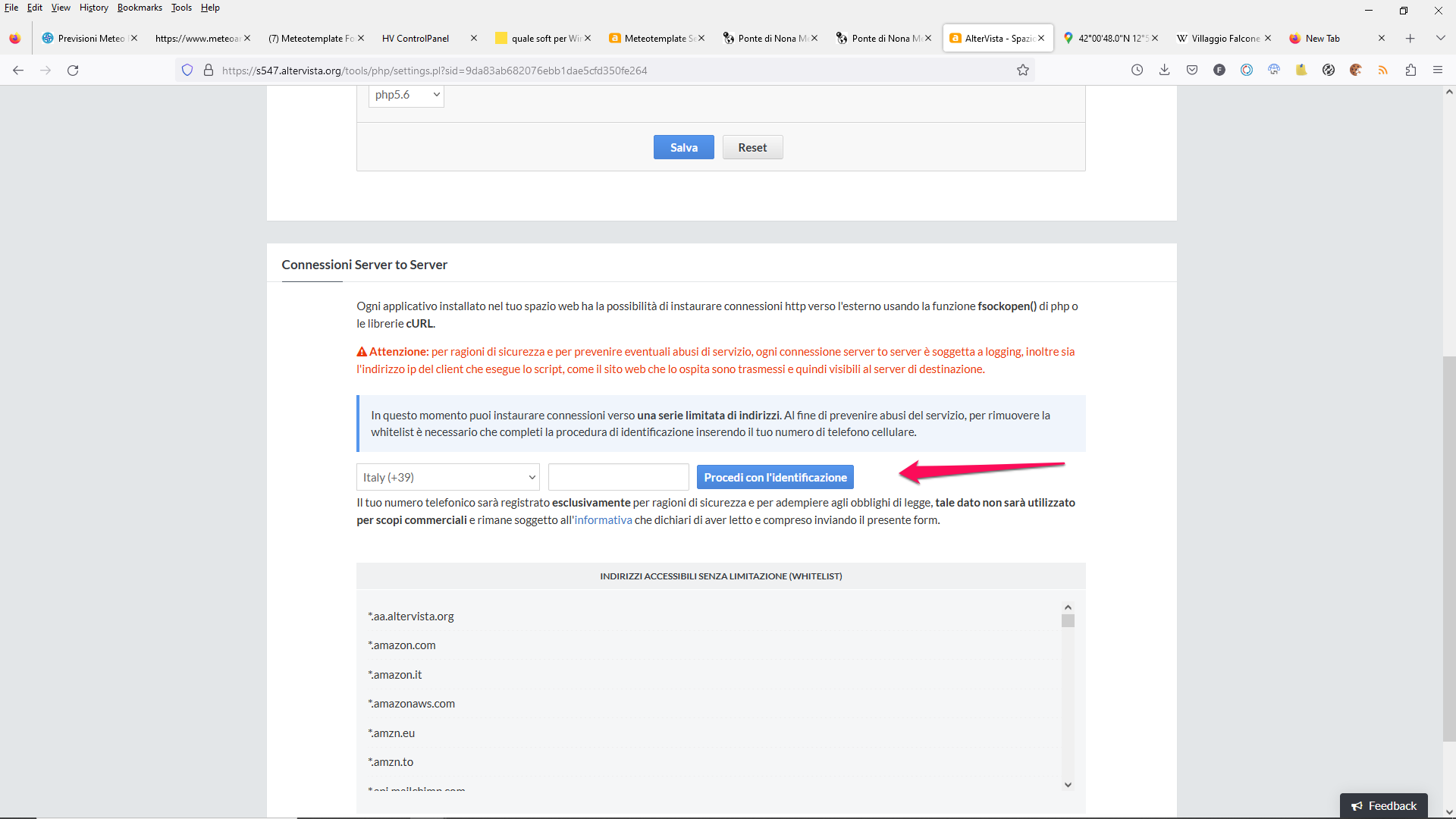

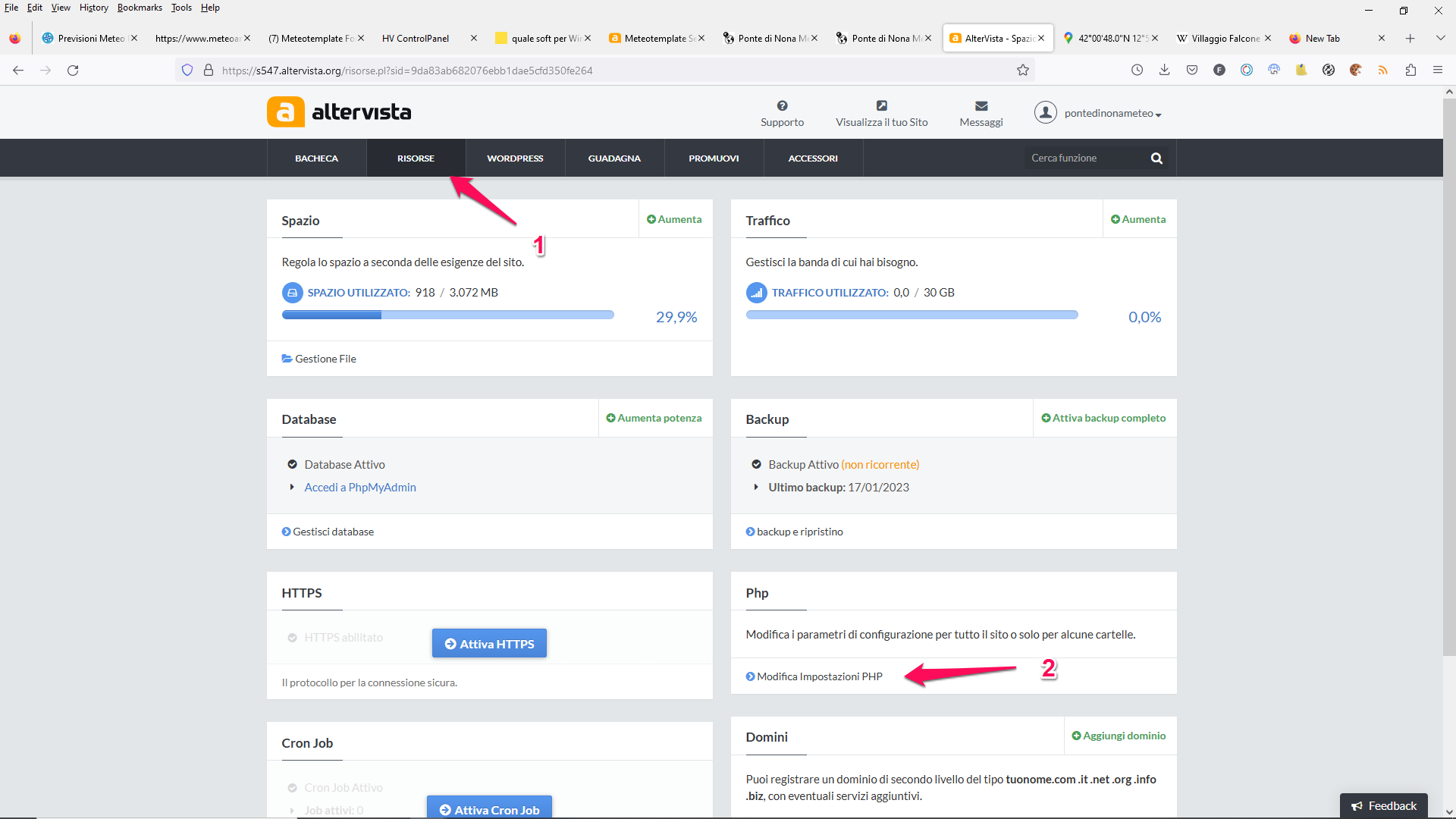

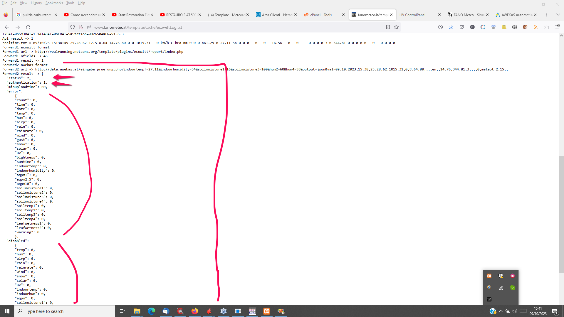

Hy ACpower, I see your site is on altervista, did you enable 'Collegamento esterno senza restrizioni ' on the control panel of altervista?
Once it is ok check your cache/ecowittLog.txt file, at the end of the file you should have something similar to the last image.
The forwarder result should contain the response from the server:
- status should be 1 or 2
- authentication should be 1.
