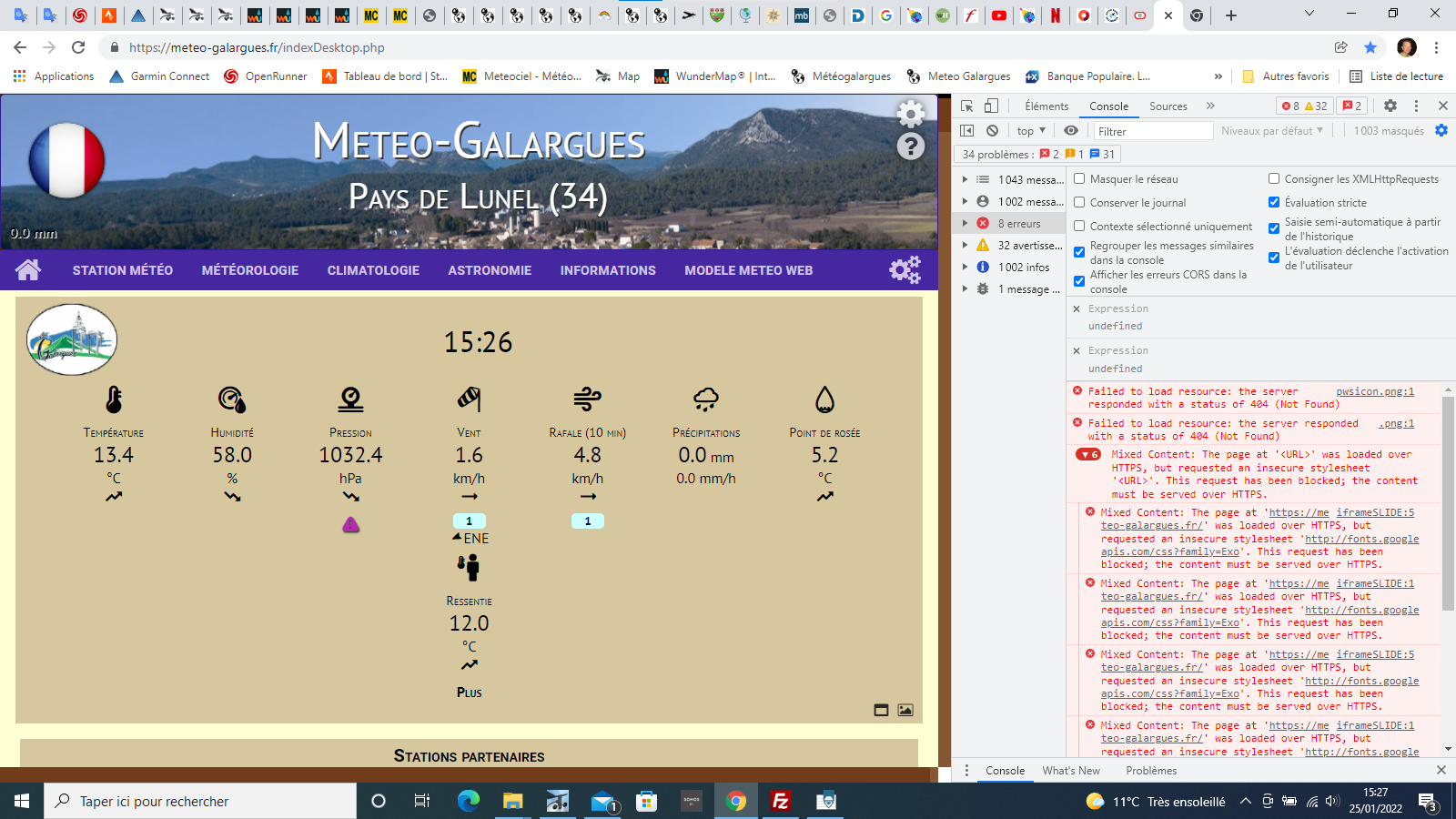

I have a problem opening my home page, it takes forever to open, more than a minute.
I looked in the developer tool of my Google Chrome search engine and I find errors there.
I don't know how to solve this problem.
I am attaching a copy-paste of the page and its errors.

Errors on opening home page
- Capture d’écran 2022-01-25 152802.png (516.2 KiB) Viewed 25391 times

Re: Errors on opening home page
Your home page is quite 'heavy' ( 17MB ) and complex so its loading time is related to these factors also.
You have a few errors that can be corrected:
- menu 'modele meteo web' has one entry 'Personal weather...' the associated icon https://meteo-galargues.fr/images/pwsicon.png does not exist
- the season icon on the lower left is undefined ( this mod solves the issue )
- the script indexDesktop.php has a small typo ( the attached one solves the issue )
- update the mapsFrance block with the attached one ( changed url of meteociel from http to https )
- worldTime configuration seems missing a configuration ( try repeating the setup ), on the forum there is also an updated block ( fixing a few minor issues, don't know if this may help )
- there are also a few blocks trying to load fonts over http ( http://fonts.googleapis.com/css ) these should be changed to https, need to check
