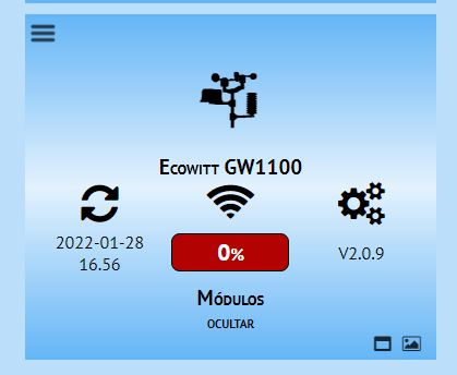

I have installed this Block on my page http://www.meteosantmateu.online/templa ... esktop.php and, as can be seen in the attached image, the intensity of the signal appears in red. I have the ecowitt 2.10 plugin installed, which works perfectly, however, the Block does not reflect it that way. I must say that the sensors that communicate with the ecowitt 1100 are from a Waldbeck Kopernikus station, which looks exactly like the WS 69. Could that be the problem?
ecowitt block.JPG (23.45 KiB) Viewed 3054 times

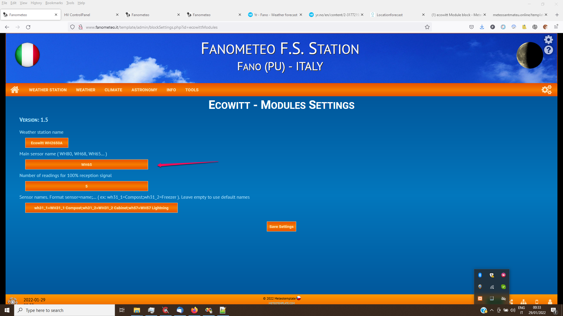

In the ecowittModules setup set the second parameter ( main sensor name ) to WH65.

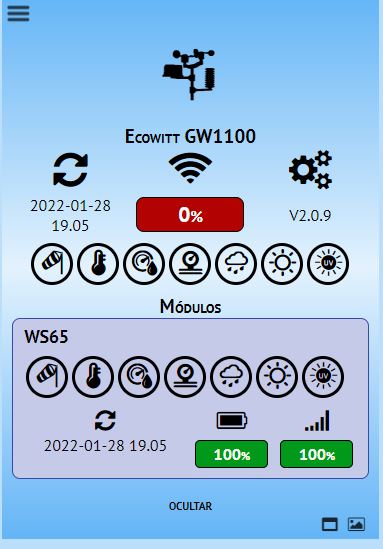

Once again, thanks for your help.
