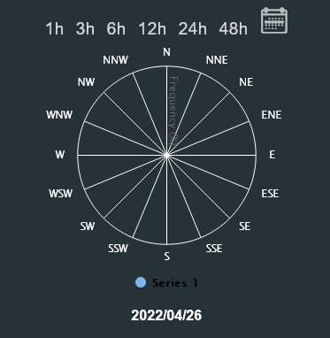

Thanks! Only problem now is that it's no longer showing anything;
Screenshot 2022-04-26 at 23-56-22 Broekermeer Weer.png (25.21 KiB) Viewed 44521 times

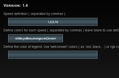

What is the exact syntax for self coloring the speeds in block config?
Re: Minimum windvalues' time?
Post by davidefa » Wed Apr 27, 2022 8:00 pm
I think you are referring to the windRose block:
- in 'speed definition' set the 'speed ranges' you want to define ( setting n values sets n+1 ranges )
- in 'define colors for each speed' set the n+1 colors ( one for each previously defined range )

davidefa wrote: Wed Apr 27, 2022 8:00 pm I think you are referring to the windRose block:

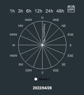

Still doesn't change the way it looks for me. Still as the image I posted before. I see no legend, no colors. Any idea what could cause this?

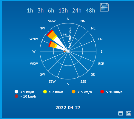

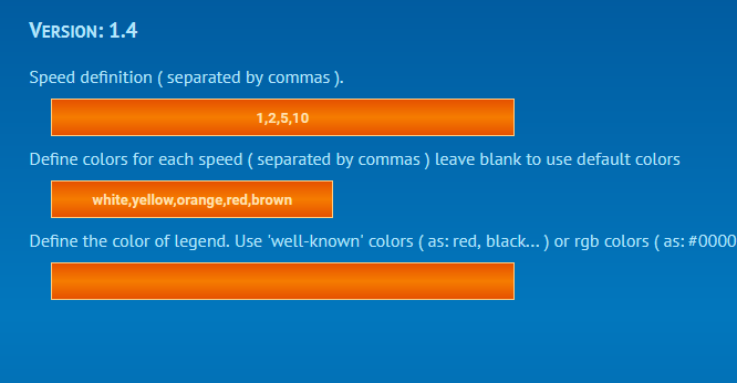

it's being tested here
Post by davidefa » Thu Apr 28, 2022 10:00 pm
You have an old version of the dataLoader.php ( homepage/blocks/windRose/dataLoader.php ) file.
Delete it and copy the attached one.
dataLoader.zip
(1.29 KiB) Downloaded 1273 times

Post by Julius » Sun May 01, 2022 10:40 am
Wow, thanks David! Really strange, I unpacked 1.4 in the windRose dir using midnight commander, but apparently not all files got overwritten..

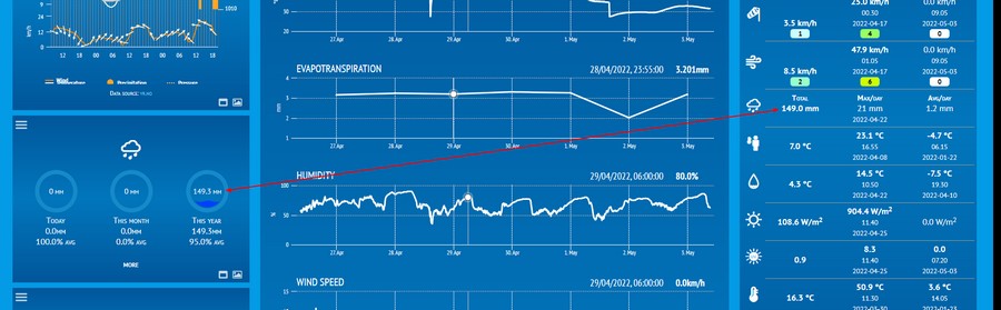

Hello David
Would you have an idea for this difference in total annual rainfall on your stationdata10.5 version?
thank you

Post by davidefa » Tue May 03, 2022 1:35 pm
ver 10.6
- corrected rain data truncated to int values
stationData_10.6.zip
(9.35 KiB) Downloaded 1109 times
