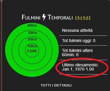

at the beginning of each month the last strike resets to 1 January 1970 without having reset either the gw1100 or the meteobridge

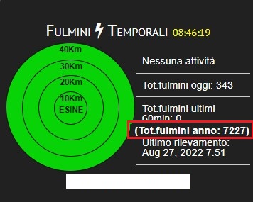

Would it be possible to move the 'total lightning year' under Strikes last 60min and above last strike?
but only total lightning, however
the other comments $tunder_txt (Storm is approaching at, Storm is going away, ...) leave them under where they are

the device works well and regularly detects lightning strikes (when there are :-), the problem I noticed is that at the beginning of each month the data resets showing the last strike on 01/01/1970
I cannot understand if it is a problem of the lightningew block, or the gw1100 gateway or the meteobridge.
I set 'Show last strike timestamp' to false (it is not consistent to display the last strike in 1970)
regarding the total strikes, I was wondering if it was possible to make a change to the block, inserting the total strikes in the lightningewBlock.php instead of in the lightningewupdater.php in order to have it aligned with the number of hourly and daily strikes.
