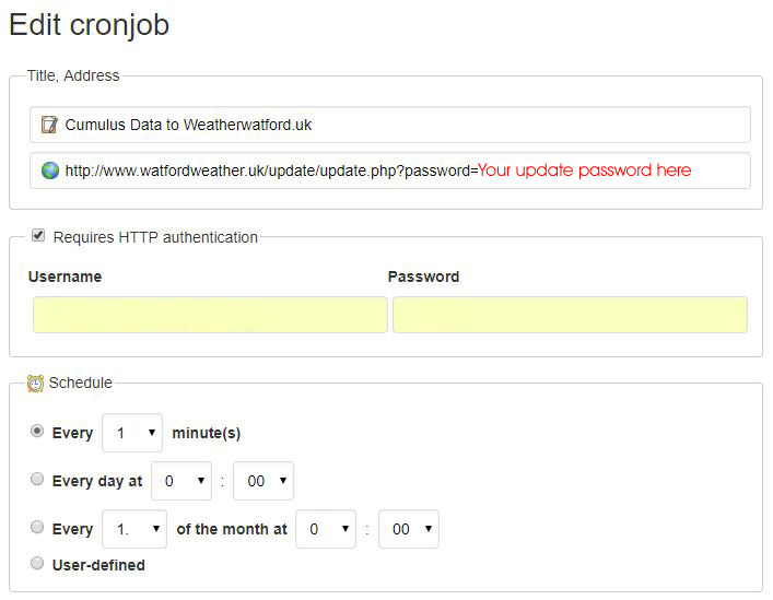

Hi Bob, welcome to the forum, I also use Cumulus to update one of my two sites, so if get stuck give me a shout and I'll see if I can help. Below are my CRON job settings for Cumulus, needless to say change the password and URL to your own.
- Cumulus-Cron-settings.jpg (48.94 KiB) Viewed 29266 times

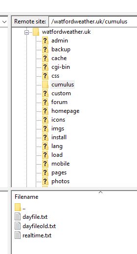

I made a folder within my web site called cumulus and that's where I tell the Cumulus software to upload the realtime.txt to.
- Cumulus folder.JPG (28.9 KiB) Viewed 29261 times

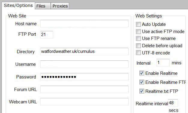

Then in Cumulus itself go to Configuration/Internet and maybe use similar settings to those shown below.
- Cumulus-software-settings.jpg (47.72 KiB) Viewed 29257 times

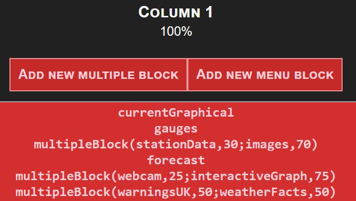

Hi Bob, looks like you're moving forward, with regard to setting up blocks - as Dave says you'll breeze through this in time.
When you've signed in go to the Homepage section, you'll see a section marked 'Setup' below are two images, one for PC the other for Mobile, click the PC one. I recall the first thing you have to choose is your column width (you can change this again if you're not happy) On my site I chose 100%, other examples are given - so you can experiment with this.
Once you've set that up you then come to your Homepage Layout Desktop, if you have installed blocks correctly they will show up further down this page under 'Installed Blocks'
In the image below is the text shown for my Column 1 box, it will give you an idea of what you have to do, compare this with my site (link below) so you can see the actual result. The numbers you see (30 & 70 and so on) are how I've apportioned my 100% width to each block.
So simply writing Forecast will automatically allocate that block 100% of the page width, but where I want two blocks side by side I would use this instead multipleBlock(stationData,30;images,70)
So you start off with saying this is a multipleblock, open bracket, the name of the block followed by a comma and the percentage width you want to allocate. Then a semicolon is used as a separator followed by the next block name and so on.
Don't forget to click 'Save' at the bottom, then you can review your Home page.
Jachym has made a detailed PDF guide on setting up your Homepage, here is the link: http://www.meteotemplate.com/web/wiki/blockGuide.pdf
- Block Setup.JPG (41.53 KiB) Viewed 29177 times
