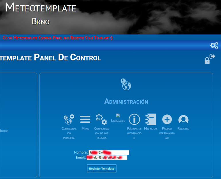

I have just installed a clean version of Cranberry on an Apache server running on a Raspberry Pi 5 (8GB).
When I get to the step of registering the template, after entering my information and clicking on the "Register template" button, the process does not proceed and the window with the message "Thanks for registering the template ...." does not appear.
The template is hosted on a server that is only accessible from my local area network (LAN).
On previous installations (Nectarine and Papaya) on Raspberry Pi 4 I have not had this problem.
Cranberry is the only template hosted on the server.
What am I doing wrong?
Thank you very much.

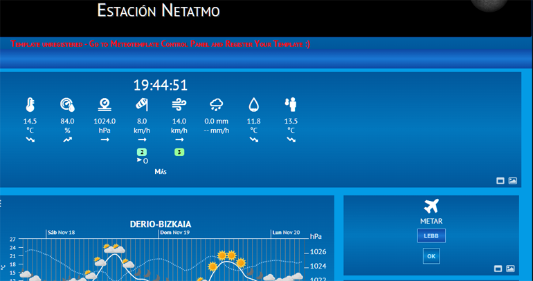

I have reinstalled everything on my RPi 5: Debian12 OS, LAMP (Apache, MariaDB, PHP 8.2, phpmyadmin) and Cranberry.
I install the template, configure it without problems and save it.
When I run the first boot with http://servermet/template/index.php, again I get the message: "Template unregistered...". I enter my data (name and e.mail) and the registration process does not run.
In the previous installation, I did a "cheat", creating a "templateRegistered.txt" file, but it worked correctly.

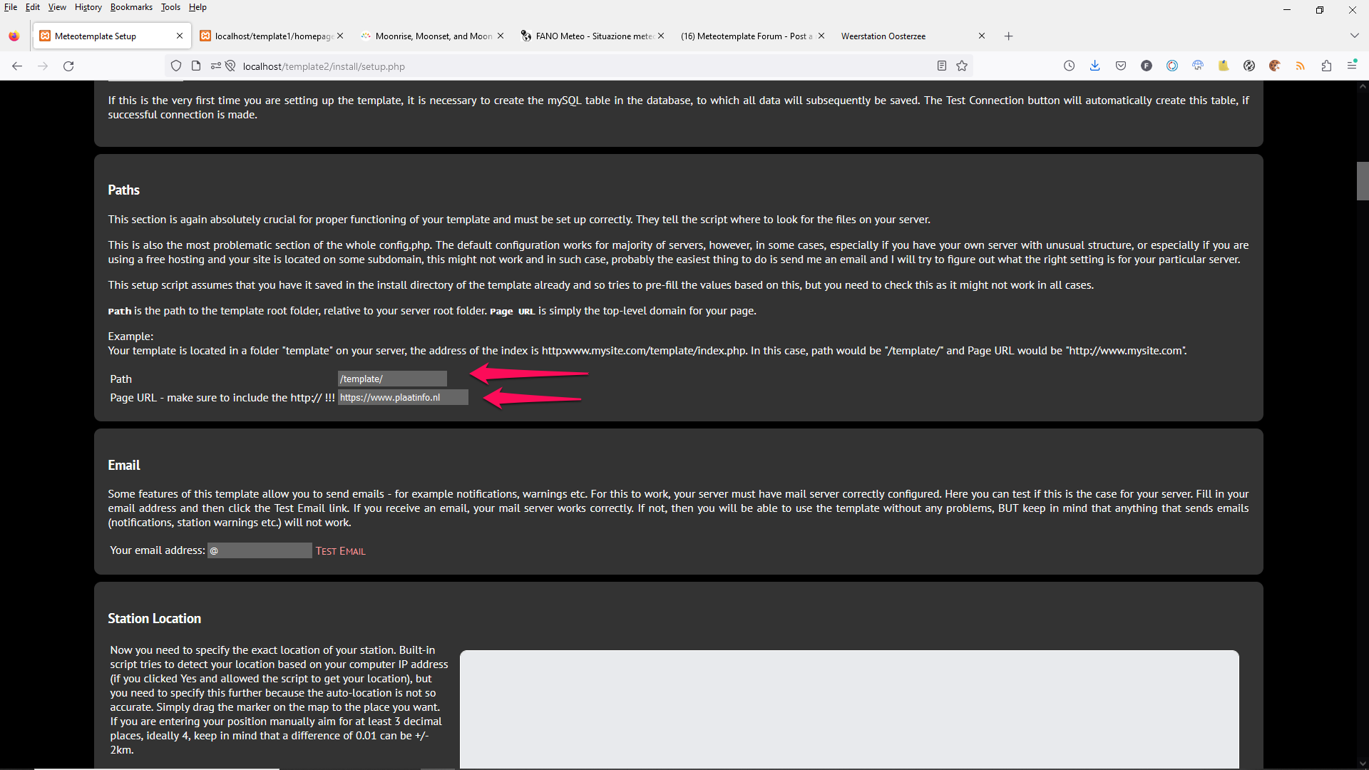

@Plaat
I see you changed the installation directory, now your meteotemplate url is: https://www.plaatinfo.nl/template/indexDesktop.php
In the meteotemplate main setup set:
- pageURL
- path
- pageURL

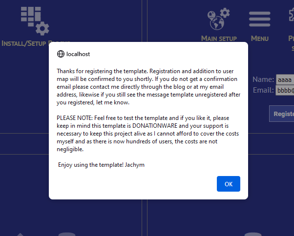

For those having problem registering meteotemplate 19.0:
- which version of php are you using?
- when you click the register button does the popup show up?
- apart from the registration, is the site behaving properly?
@edogara89
What is the url of your site?

Hi davidefa.
Thank you very much for your interest.
1.- PHP version 8.2.11
2.- When the registration page appears, I type my name and e-mail, click on the button, but no popup opens.
3.- The operation of the template is erratic. For example, when I try to configure the first three blocks (airQualityWorld, baroTrend, calculator), airQualityWorld always opens.
My installation is quite special. My template is hosted on a Raspberry Pi 5, only accessible from my local area network. If I give you my url, you will not be able to see my template.
On my Papaya template, hosted on a RPi 4, I have never had any problems with registration.
Regards and thanks
