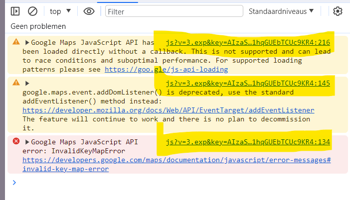

I'm still working on a new version of my weatherstation site. Everything seems to work fine, but het climat map won't load. Error message: Oops! Something went wrong loading this page. Google Maps is not loaded .... See Javascript console .. etc.
I opened the Javascript console and noticed that it uses an old API Key I deleted on the Google Maps Platform

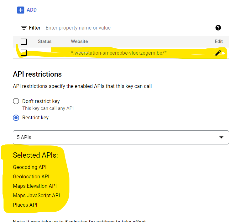

Here's wat I did:
1. Deleted an old API Key on the Google Maps Platform
2. Restored my billing information on the same platform
3. Configured the (right) settings to use the key (see screenshot)

5. And still the climate map page uses the old Google Maps API key
I wonder if it is right to execute the "setup.php" again, but I think this will change the configuration of the site completely. So, I'm asking for advice for this issue.
