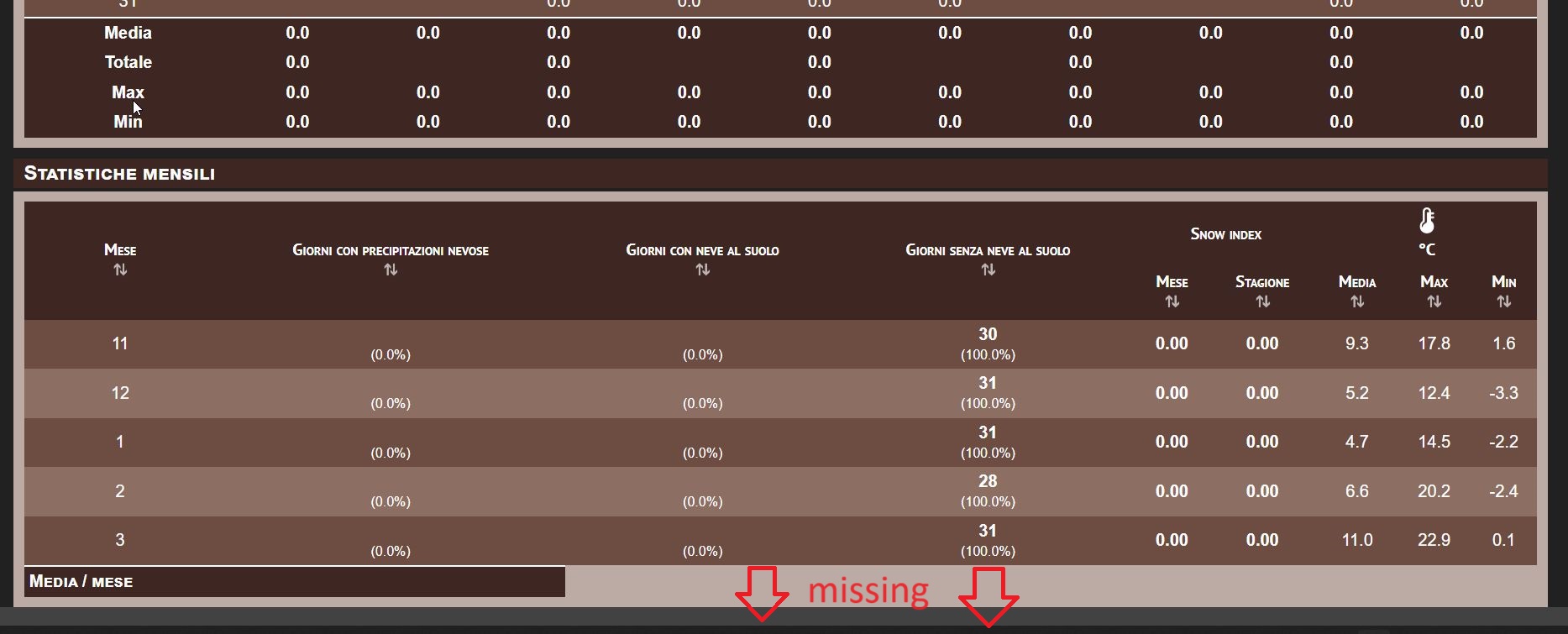

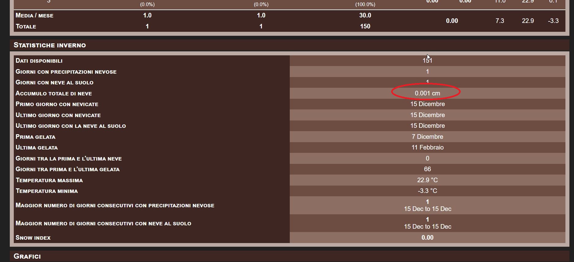

I noticed that if there are no snow accumulations in a season, in my case last season 2022-23 (leaving the values of all months at zero), the reportSeason.php and allSeason.php do not display correctly (they only display in part) the reports; while if you add even just a 0.001 to any day it is displayed correctly (but recording a non-existent snow day)
Is this just my problem or are others experiencing this problem too?

grazie Davide, ma il problema rimane anche con gli ultimi aggiornamenti.
https://meteoesine.it/template/plugins/ ... eports.php
guarda la stagione 2022-2023 (dove è tutto a 0 perchè non ha mai nevicato) il report viene visualizzato solo a metà rispetto alle altre stagioni che hanno registrato almeno 1 giorno di neve - si interrompe alla fine delle 'statistiche mensili';

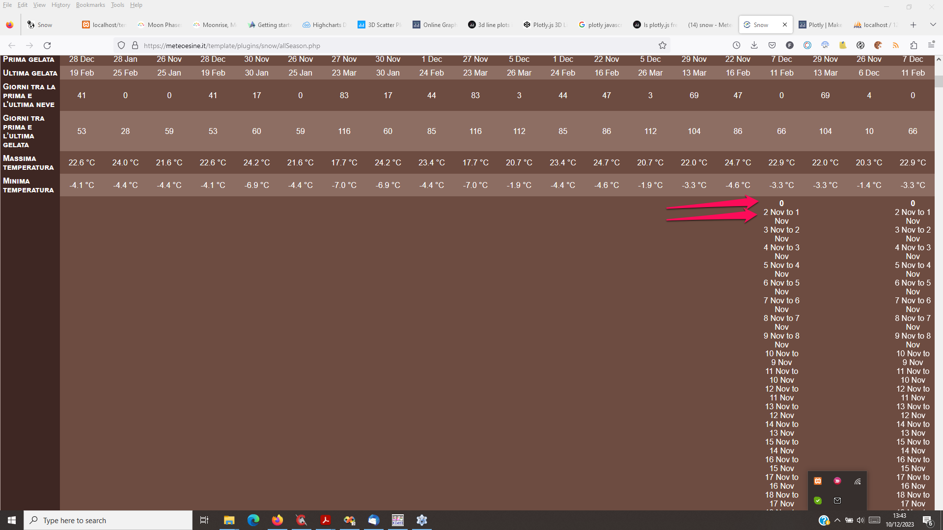

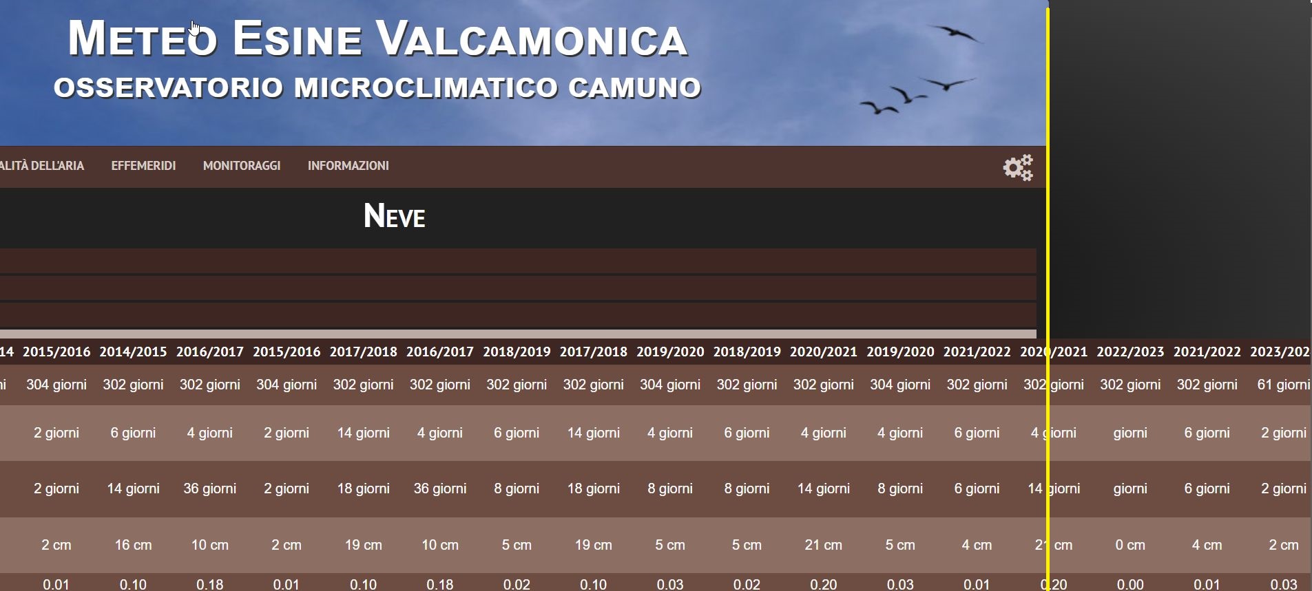

Inoltre, ora, nel riepilogo generale: https://meteoesine.it/template/plugins/ ... Season.php
nel confronto inverni, le colonne delle stagioni sono visualizzate a casaccio: 2014/2015 - 2013/2014 - 2015/2016 - 2014/2015 ... e poi la tabella si allunga al di fuori della videata.

Ok, You sould post/pm me your snow mysql table ( use phpmyadmin to make a backup ).
The allSeason.php script has a few problems ( and I can't replicate it with my data ):
- in 'confronto inverni' every column is repeated twice
- the row 'giorni consecutivi...' for season 13/14 and 22/23 ( when no snow was recorded ) is wrong and reports all days

Re: snow
Yes, I already uploaded plugin ver 4.3 and it was working... but now I see plugin ver 4.1.
I reuploaded ver 4.3 and it is working again now ( the zipped plugin is in the plugins directory ).
Does it work correctly now?

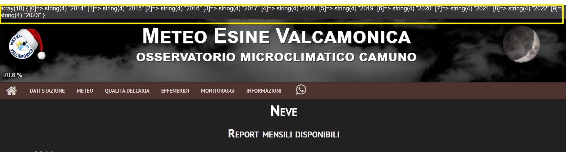

allSeason.php is OK but snowReports.php still not:
shows a string of errors above the header and again the report stops at the monthly statistics (season 2022-23 when everything is at 0)

Re: snow
Thanks you very much Davide, great job as always
I take this opportunity to wish you and the all the forum's users Merry Christmas.
The fixed plugin is attached
