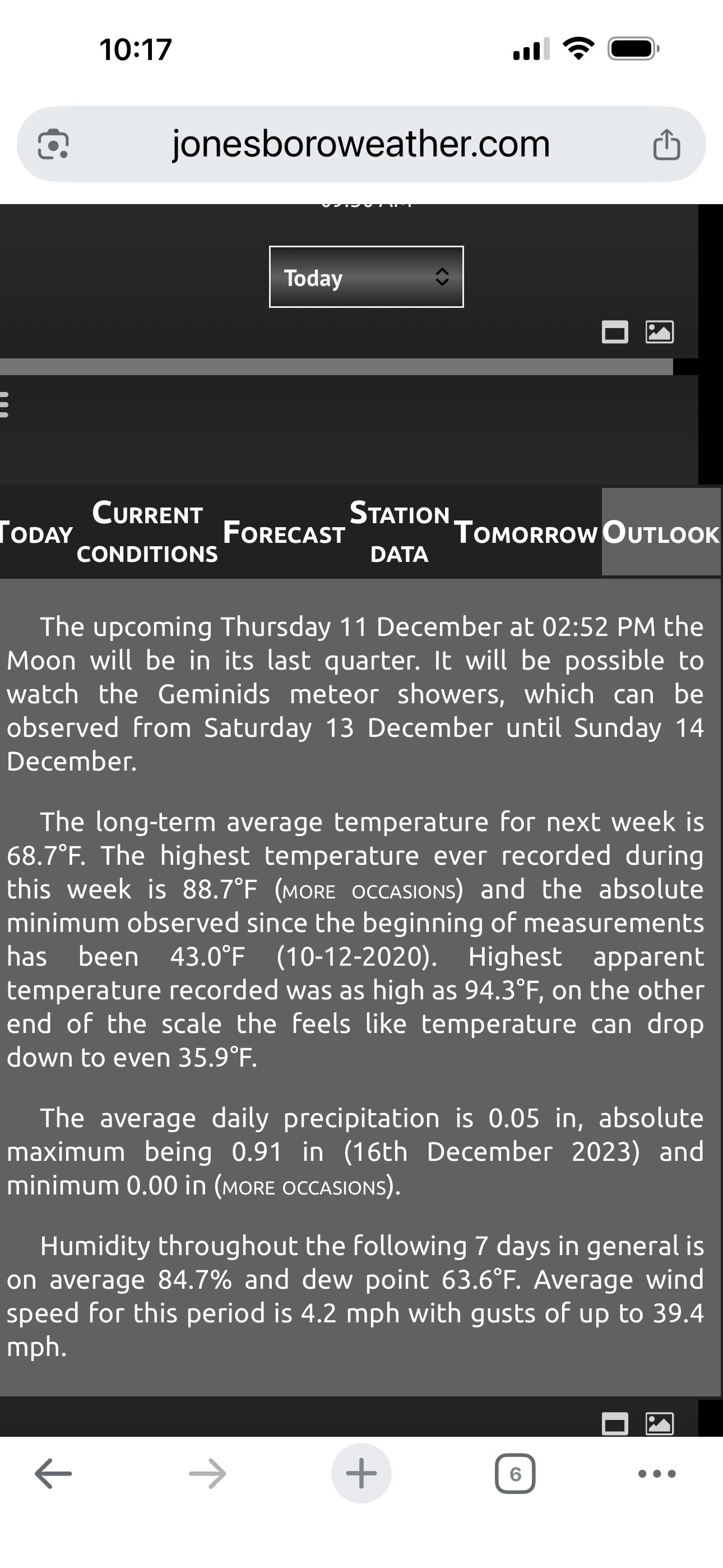

What have I missed my current conditions block is fine except for forcast it is still getting the forcast from florida and im in Ar now
Got to be a stting i missed somewhere after my move

You mean the 3rd block at your page?
Headlines "Today - Current Conditions - *Forecast* - Station Data - ..."?
Which block/plugin is that?
Did you check in setup section if there is some value to set (or modify)?

Yes i have checked the block
And lon and lat is correct
No other settings
Got to be something in the file I have reverified the settings was hoping someone one else had the issue
In current conditions
It is still reporting my old location in flordia

Did you check forecast block?
What lat/lon values are in ../pages/forecast/cache/current.txt?
Do they match with your current coordinates?

From where do you get the forecast data, openweather map?

There is a link in the block in cp but its just lat and long
It is not current conditions block it is the summary block that has the wrong data
Under the tabs
You can see how wrong that data is

The Summary block uses yr.no for getting the forecast data.
Did you configure it with the correct string: "United States/Arkansas/Craighead/Jonesboro" ?
