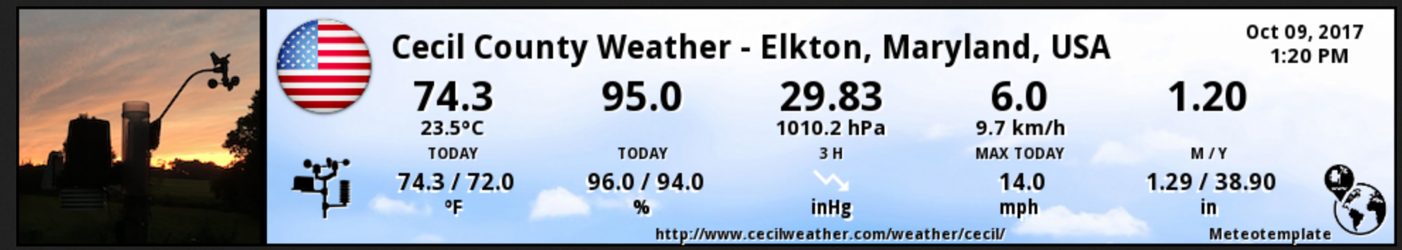

Post by MonyMony » Mon Oct 09, 2017 5:32 pm
When I have my sticker set to use the DualUnits=1, I have noticed I am only showing Inches (my primary units) but not mm. I see metric measurements for the other parameters so not sure why rain would be different. Is this by design?

Re: Interactive Sticker (Trivial) - Missing Millmeters when set to DualUnits
Post by Jachym » Mon Oct 09, 2017 10:16 pm
This is indeed strange.... I dont really see how that can be happening given the other ones are showing ok. I will look at the code tomorrow
Post by Jachym » Tue Oct 10, 2017 12:52 pm
Found the issue, please update the plugin to the latest version.
Post by MonyMony » Tue Oct 10, 2017 1:30 pm
Updated, and not seeing any millimeters. Is this due to no rain today or something else?
Post by Jachym » Tue Oct 10, 2017 1:41 pm
MonyMony wrote: Tue Oct 10, 2017 1:30 pm Updated, and not seeing any millimeters. Is this due to no rain today or something else?
DId you update manually or used the auto update?
Post by Jachym » Tue Oct 10, 2017 1:42 pm
However either way it should show at least the unit label, it is the exact same code as for the other parameters
Post by MonyMony » Tue Oct 10, 2017 1:57 pm
Jachym wrote: Tue Oct 10, 2017 1:41 pm DId you update manually or used the auto update?
Manual, after auto took too long (did not see your note initially). Let me for everything to overwrite in case something strange happened and see if that makes a difference.
Post by Jachym » Tue Oct 10, 2017 1:58 pm
This really makes no sense since it is the exact same line as for the temperature for example and even if the number for some reason didnt work, it should at least show "mm"
Post by Jachym » Tue Oct 10, 2017 1:59 pm
Never mind, I see the issue, I will update it tomorrow again. There was a typo and I just noticed it was used twice in the script and because I copy/pasted it the typo got carried over to the other line too.
Post by MonyMony » Tue Oct 10, 2017 2:01 pm
No worries and certainly no rush.
Thanks!
Post by MonyMony » Wed Oct 11, 2017 12:10 pm
Thanks Jachym... confirmed this issue is resulted with v7.2 of the Stickers plugin.
