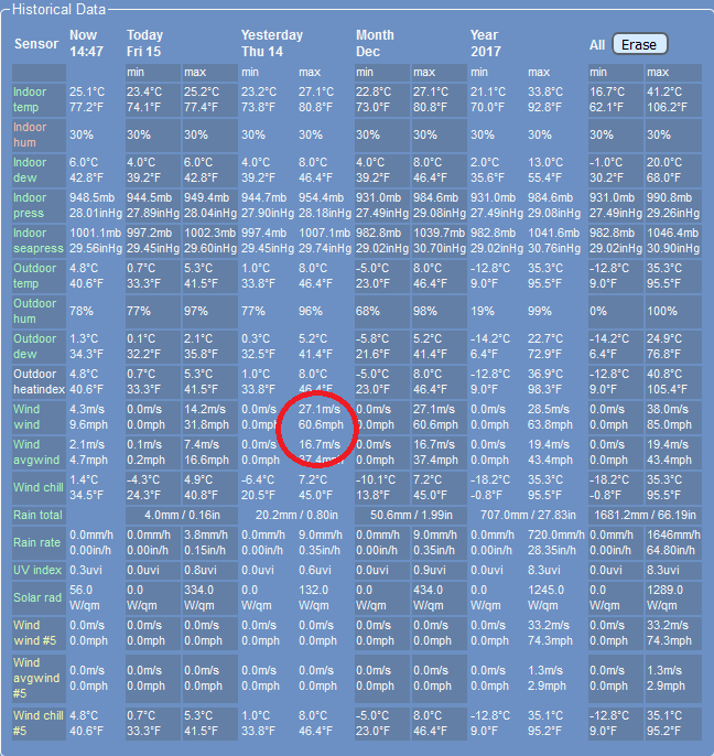

ok, that is strange, MB should be sending maximum value, not current value. Do you see the maximum in your MB control panel?

yes, I do :
Screenshot-2017-12-15 Meteobridge.png (85.38 KiB) Viewed 5518 times
