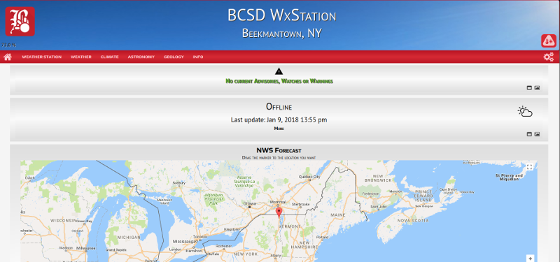

Still having an issue that is still intermittent. Values show and then do not appear later on in the Current block. After a few cycles, the values will appear. Here is what it looks like without the values. Could it be a permissions issue?

Re: WU has no elements
Post by Jachym » Tue Jan 09, 2018 7:33 pm
More likely CRON problems. If it works "sometimes" it cannot be permission issue or script issue. In such case it would never work.

Post by danville » Tue Jan 09, 2018 10:49 pm
I think the Current block is not working. My Weather sticker shows the correct weather station readings. The Current block still reads Offline.
