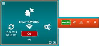

A few days ago I have installed a station is Ecowitt Wittboy GW 2001.
It seems to me that I have successfully configured the "ecowitt" plugin (V 3.5a), because the web page appears "online". However, the block "ecowittModules" (V 1.6) is offline.
In the image is my block configuration.
What am I doing wrong?
Please, forum experts help me to discover and correct my mistakes.
After the failure with the Netatmo plugin, I have been "fighting" with the new template configuration for several days.
Thanks in advance.

Personally, I've always stayed on 1.0 and never had a problem.
- Capture d'écran 2024-07-12 181226.png (113.79 KiB) Viewed 43499 times
El_Viejo
- Posts: 105
Re: updated ecowittModules block
I am coming to the conclusion that my error is in the plugin configuration.

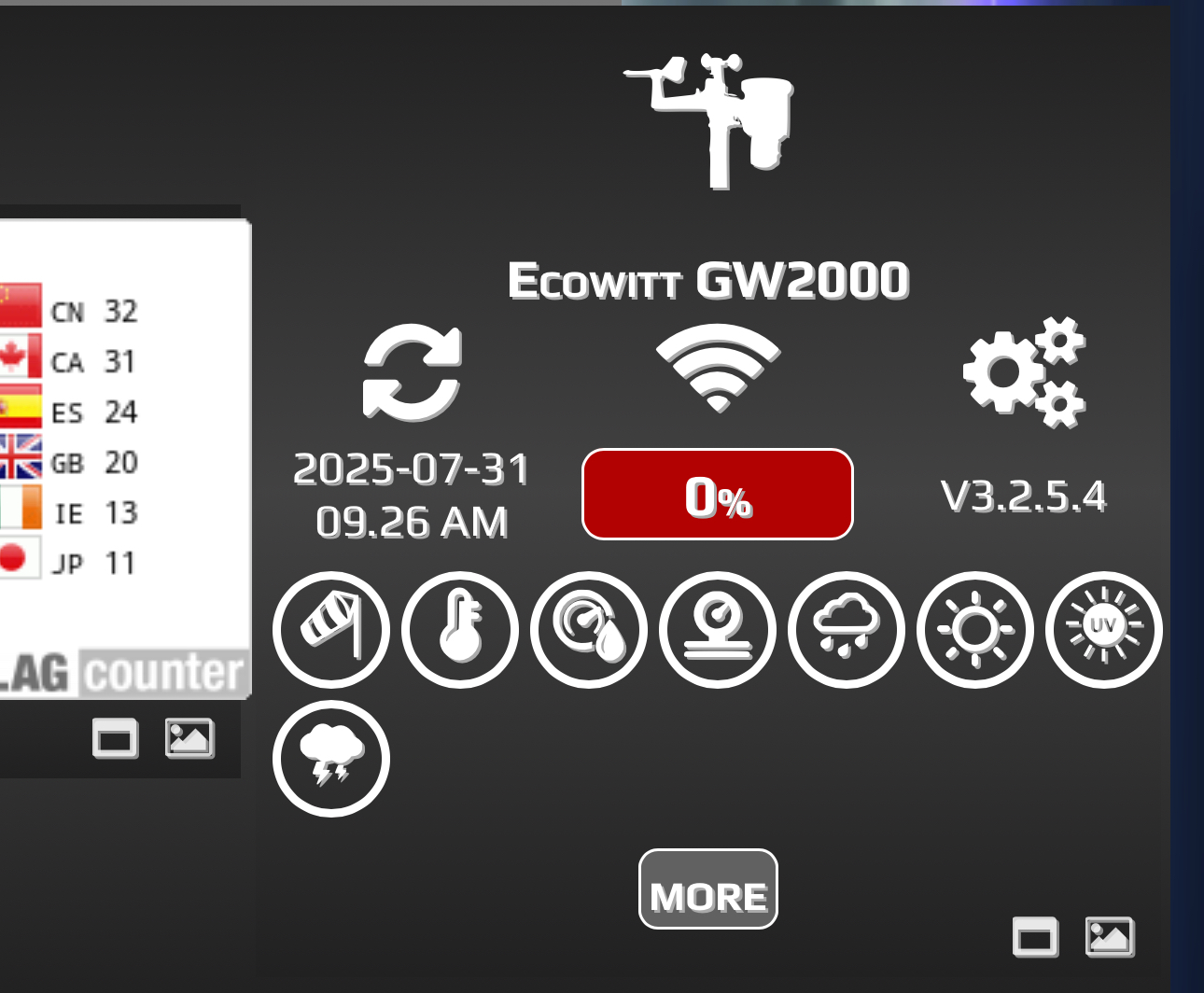

Why does my signal meter stay red and at 0
All the other indicators are displaying i am using a Gw2000 with a WS90

I removed it to many php 8.2 errors slowed my site and the percent meter stayed red at 0

I don't know. I lost a bunch of symbols on mine when I just upgraded to PHP 8.2 from 8.1. My host won't let me go back to 8.1 now. My site counter broke also with 2-3 other blocks.
